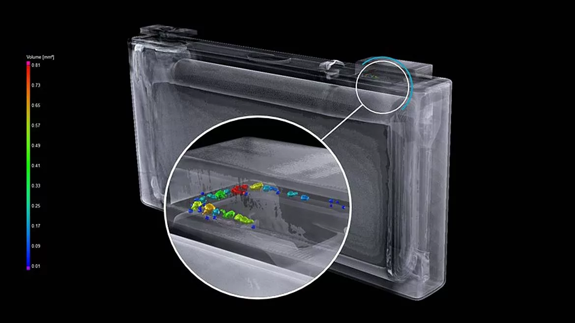

Porosity detection in the weld seam of a battery.
Image courtesy of Volume Graphics, a Hexagon company. Scan courtesy of Waygate Technologies.
Porosity detection in the weld seam of a battery; the size of individual pores is indicated by color. Image courtesy of Volume Graphics, a Hexagon company. Scan courtesy of Waygate Technologies
During prismatic cell production, porosity caused by welding battery-casing components together may cause dangerous leaks and reduce battery function. Weld-seam porosity is almost impossible to avoid completely, but it can be reduced through post-analysis weld-parameter optimization.
Porosity inclusion analysis helps quality engineers decide whether a particular pore is a reason for concern; manufacturers can leverage this analysis to ensure the integrity and optimal performance of their batteries.
