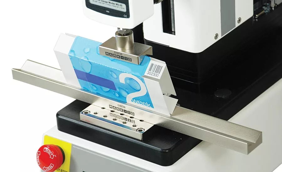

Medical packages are tested
Medical packages are tested to determine opening force.

A wide range of grips and fixtures is available for testing a plethora of materials, but choosing the correct grip is of utmost importance. If the grip is not suitable for the material undergoing testing, the material will slip and testing will be unsuccessful. It is also important to estimate the maximum force capacity for your test before choosing a grip, as each grip has a specified use capacity. Wedge grips are generally used for rigid metal or plastic samples. Parallel jaw grips are versatile and can be used to test fabrics, films, and semi-rigid materials. Wedge and parallel jaw grips can be fitted with various surfaces: plain jaws, serrated jaws, interlocking wave jaws, and rubber jaws. Wire and rope grips are available to test wire, rope, yarn, tubing, and elastics. Specialty opening force fixtures enable to the opening force of box cartons to be measured. A flip cap grip can be used to engage a flip cap tab for pull testing. Specialty fixtures such as a syringe compression fixture conform to relevant ISO standards to allow for medical testing of a syringe plunger. Basic attachments such a simple flat attachment, a compression plate, or a hook enable a variety of material and product tests.
