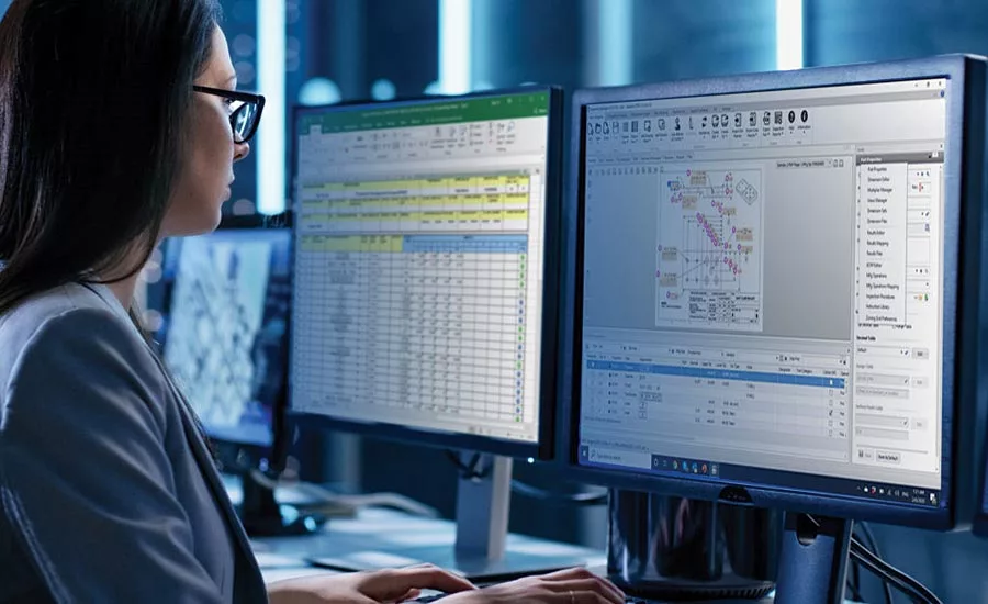

Screen shot displays automatic ballooning
Screen shot displays automatic ballooning and GD&T extraction on a scanned 2D drawing. This task, done automatically, saves sometimes days of time. It is also helpful assurance that the initial inspection and measurement data collected at the start of the work order process is reliable and accurate.
