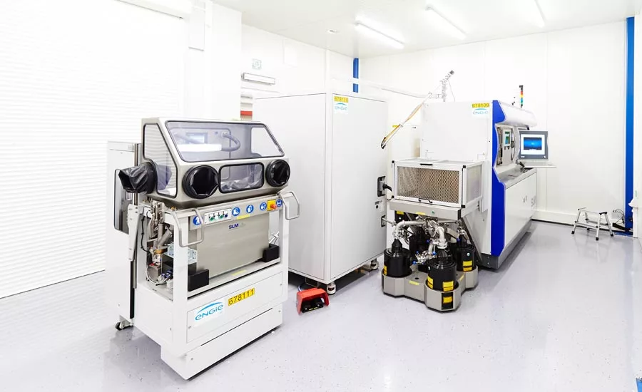

The Shell Technology Centre Amsterdam (STCA) has been awarded a best practice qualification for its powder bed fusion 3D printing facility from Lloyd’s Register (LR).
