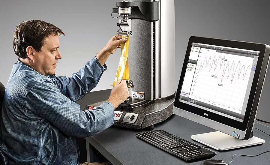

An operator is monitoring the results of a freehand peel test. Image courtesy of The L.S. Starrett Company.

Peel testing in force measurement can be rather open-ended in terms of how the standard operating procedures (SOP) can be written. Examples of lengthwise testing may include something as common as tape reels to as uncommon as aircraft decals – yet the methods for testing one in comparison with the other can be mistaken for being functionally identical. Some standards, such as ASTM D3330, refer to multiple methods for testing similar samples, so the issue when designing an SOP for measuring force application becomes discerning what test method to utilize. Consideration must be given to the conditions that the materials will be exposed to, necessitating understanding of both the procedure setup and data analysis.

Freehand Applications
ASTM Standard F88 is used to demonstrate the strength of seals. It refers to a series of fixture styles that can be used to hold free-floating seals for testing. A sample can be demonstrated by using a pair of hook-and-loop strips, with one end of one strip held in the bottom fixture, and the opposing end affixed to the upper. When pulled apart, the hooks separate from the loops, allowing the force required to separate the strips to be measured. But if allowed to remain unfixed, the length of the hook-and-loop strips will be left to freely change angle during the test, which can affect the results. This is referred to as a freehand peel, and be corrected by holding the combined hook-and-loop strip ends so that they are perpendicular to the separated ends, though there is some use to testing without interference. There are ASTM standards specifically for hook-and-loop materials, but some, such as ASTM standard D5169, are designed for testing other properties, such as the shear strength of the material rather than peel separation. The force application is different, which is why it is recommended to refer to a different standard for test setup and data collection when running a shear test for hook-and-loop as opposed to a peel test. For peel testing hook-and-loop, ASTM D5170 is an accepted standard.
An example of a freehand peel is the opening of a bag of potato chips. Often, the seam of the bag is pulled apart at a perpendicular angle by hand. Performed on a UTM, this would involve grip fixtures to separate a similar seam by holding the unconnected sides. Different fixtures, however, will yield different results. A fixed bottom jaw with a free-hanging rope or chain jaw would better emulate the inexact angling performed when a chip bag is opened by hand. This allows one end of the test to freely move around the other, resting at the optimum angle for testing without forcing perpendicularity.
