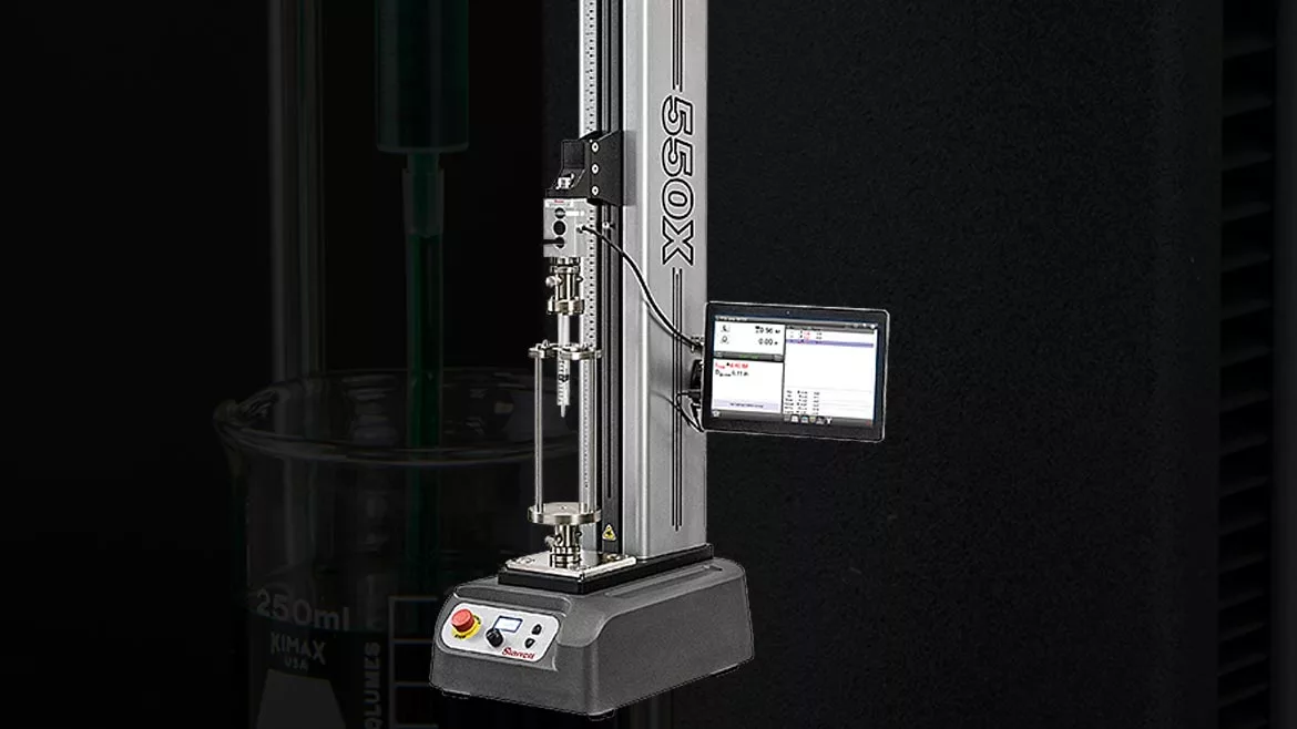

QM 0622 Quality 101 FMS 5000 with syringe cUSa1 02
Starrett FMS Series test frame set with a disposable syringe without a needle. Application testing the average draw forces without a sample liquid. Source: The L.S. Starrett Company

Once the syringe is manufactured, there are multiple aspects that can be tested in force applications to ensure the quality of the device. To begin, the needle can be tested with a proper mounting and membrane emulating the intended surface to be pierced, and with a uniaxial tester, an insertion and extraction load test can be performed. With the insertion, you will see the peak force required to penetrate the surface, and any notable distortions in the force as a result of drag as the needle travels downward. Once done, the force tester can reverse direction, tracking tensile loads rather than compression, making similar notes for any drag forces until the syringe needle is removed.
Additional testing can be performed with draw and injection forces. Properly affixed, the plunger from a syringe can be withdrawn from the barrel to draw liquid from a basin below the sample. Variable speeds can be checked to verify the draw amount and force generated. Drawing forces would be best demonstrated with pulling samples or doses from vials, or drawing blood from donors or patients. Reversing direction will provide the injection force, measured across the reversal of the draw. Important items to keep in mind while testing these applications are to make sure the same amount is drawn from the sample basin each time at different speeds and when testing speed, draw rate is important to ensure the plunger and stopper retain their seal.
