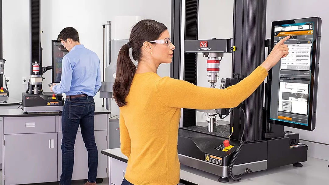

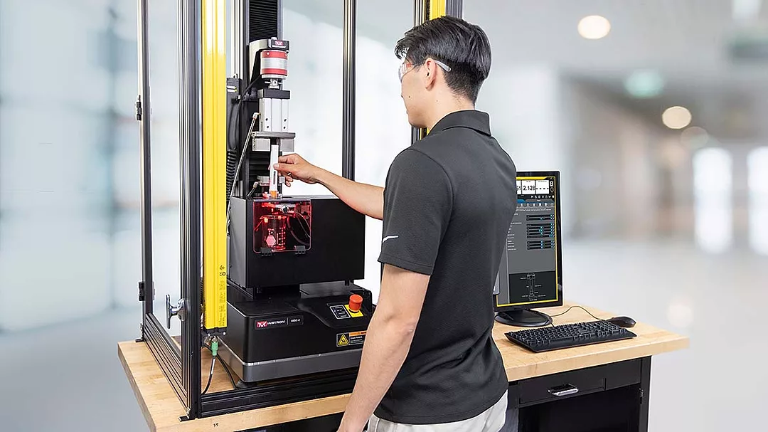

Product complexity is not new, but the way engineers test complex products has changed. Sammi Sadler, senior applications engineer at Instron, points to drug delivery devices as a clear example. Autoinjectors require multiple force-related checks, including cap removal, activation force, click detection, injection time, needle depth, delivered volume, and needle guard lockout.
“In the past, labs often needed several systems to perform all those tests,” Sadler says. “That approach took time and introduced variation between setups.”
Semi-automated systems now allow labs to combine those steps into a single test sequence. Engineers can run one program instead of moving samples between machines. That consolidation improves consistency and reduces handling errors, particularly when labs test large volumes of product.

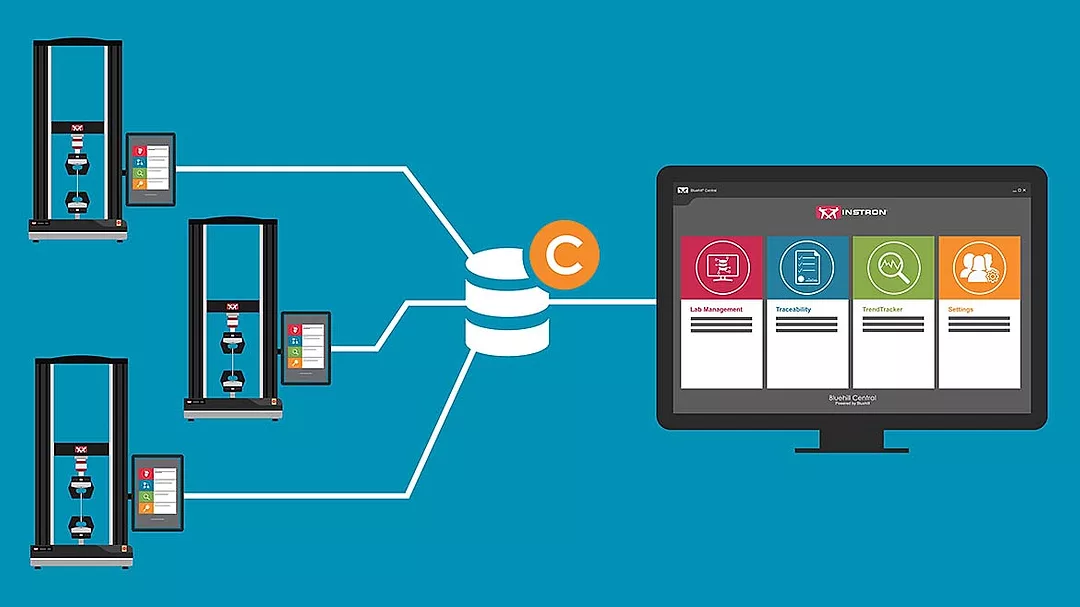

Hardware improvements alone do not explain how force testing has changed. Software and connectivity increasingly shape how labs run tests and manage results. Stephan Botzki, senior applications engineer at Instron, says manufacturers with multiple labs face pressure to standardize methods and control access.
“Global manufacturers often operate several labs,” Botzki says. “They need confidence that everyone follows the same procedures and uses the same test definitions.”
Centralized lab management platforms allow quality teams to distribute approved test templates, manage user permissions, and maintain audit trails. Engineers can review results remotely and track file revisions without relying on local spreadsheets or shared drives. That structure supports regulatory compliance while reducing administrative work at individual sites.

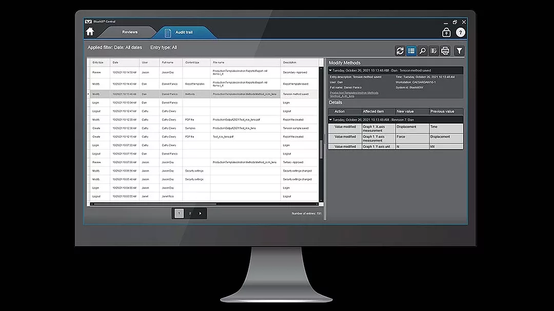

Digital traceability tools capture method changes, electronic signatures, and audit trails automatically. Engineers no longer rely on paper logs or separate databases to reconstruct testing history. When issues occur, teams can identify who performed the test, which method they used, and when changes occurred.
