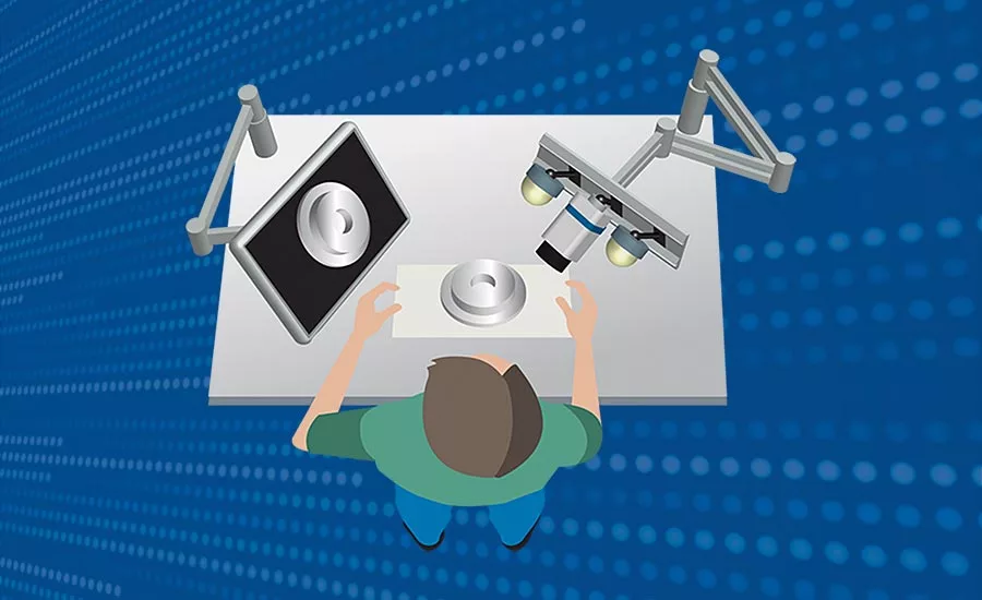

An emerging area for AI is automating or adding decision-support for manual inspection, where manufacturers report errors rates as high as 30 percent. Humans are well-suited for inspection tasks, but when we get tired or distracted AI is a powerful tool to help alert us of issues and guide our decisions. Automating manual inspection speeds inspection rates, improves end-to-end product quality, and provides more qualitative product evaluation to ensure manufacturing processes are repeatable and traceable.
New systems for manual inspection leverage no-code algorithm design and edge processing deployment, together with cameras, lighting, and display software. The plug-and-play system is easily trained on a manufacturer’s unique data to implement end-to-end quality checks and workflows, without requiring software coding skills. An intuitive user display guides operators through the manufacturing process and automatically identifies and visually highlights differences and deviations.
Image 3: Automate Manual Inspection
Image 3: The combination of easy-to-program AI algorithms and edge processing enables turnkey inspection systems to automate manual inspection. Image Source: Pleora (Click on image to enlarge.)
