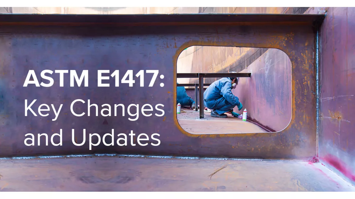

NDT | Liquid Penetrant Testing
ASTM E1417: Key Changes and Updates
In October 2021 ASTM E1417 was published, replacing the 2016 revision. This revision was completed as part of a standard review cycle, and to address changes in the industry.
By Shawn Kilty, David Geis
QM 0422 NDT ASTM E1417 Revisions feature
Image source: Magnaflux
