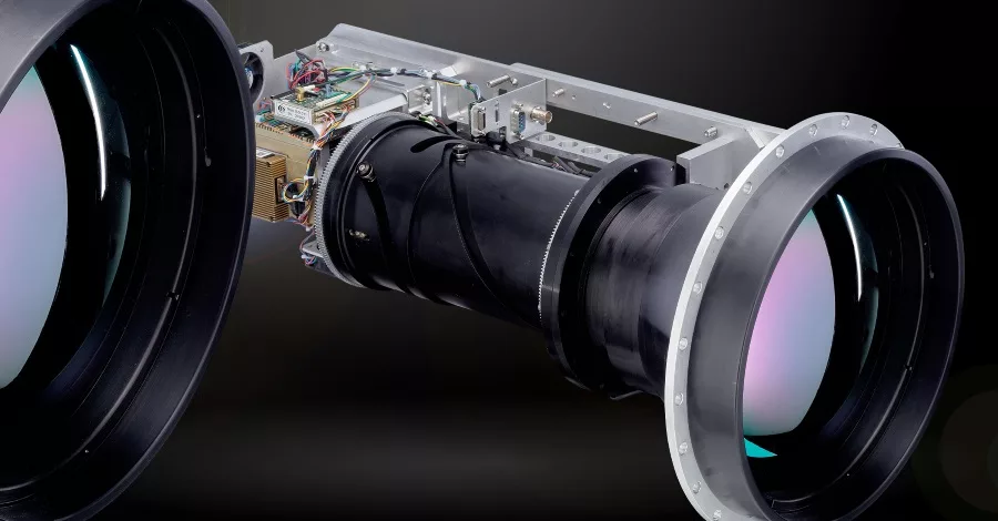

Teledyne FLIR, part of Teledyne Technologies Incorporated, introduced the Neutrino SX12 ISR1200, the first model in the new Neutrino Ground ISR series of high-performance, MWIR camera modules with integrated CZ optics. The HD MWIR system combines a Teledyne FLIR MWIR camera module and 120mm to 1,200mm CZ optics with industry-adopted imaging electronics from InVeo Designs LLC to provide a best-in-class ISR solution with low-switching-cost for defense and industrial integrators.
Based on Teledyne FLIR focal plane array (FPA) technology, near diffraction-limited optics, and a long-life linear Stirling cooler with 25,000-hour MTTF, the Neutrino SX12 ISR1200 offers 1280x1024 resolution with 12µm pixel size. It also features dual-parallel outputs using a 60Hz Camera Link base with 1080P30 HD-SDI or 720P60 HD-SDI, ideal for tracking, turbulence mitigation, and artificial intelligence. The SX12 ISR1200 is a turnkey system that is ideal for integration with ground-based, long-range ISR, perimeter surveillance, border surveillance, and counter-unmanned aircraft systems (C-UAS).
The long focal length CZ lens was developed and is produced by the Teledyne FLIR team, formerly of New England Optical Systems (NEOS), which joined FLIR in 2019. The system provides autofocus, focus, and boresight retention through zoom, and it is factory optimized for each integrated system. The lens, the MWIR camera module, and imaging electronics are all designed and manufactured in the United States.
