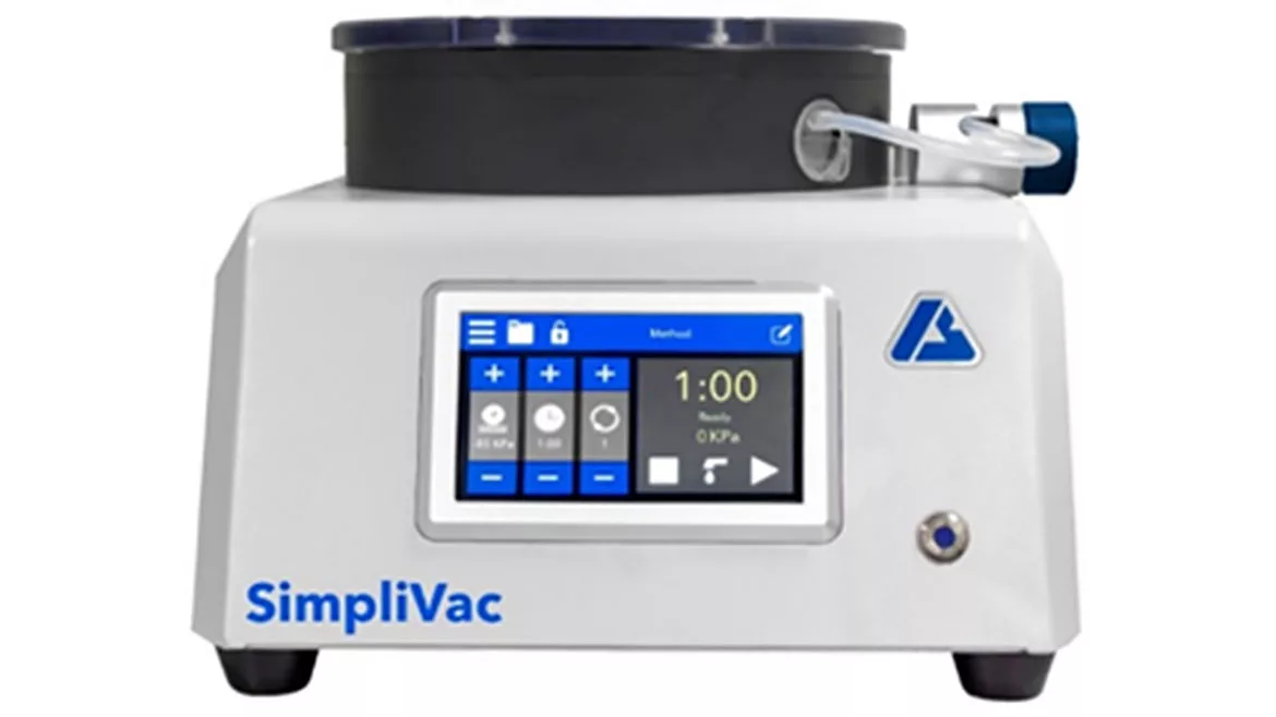

QM 0722 Test & Inspection Figure 3 Vacuum impregnation equipment for mounting porous samples in epoxy with multiple vacuum cycles
Figure 3 - Vacuum impregnation equipment for mounting porous samples in epoxy with multiple vacuum cycles

Mounting: After cleaning and drying the cross-section, it should be mounted using a low viscosity epoxy. Best results are found when mounting under vacuum (Figure 3), to ensure penetration of the epoxy into cracks and voids. Multiple vacuum cycles are far more effective at ensuring penetration of the epoxy than extended times under vacuum. For particularly hard coatings, additives can be used in the epoxy to provide extra edge support through the preparation process.
