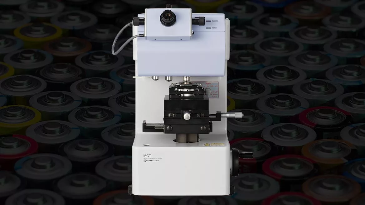

An image of a micro-compression tester and schematic of the test are shown in figure 1.
The PC controlled system is comprised of the following components: a top-mounted optical 500X sample imaging unit with micrometer and PC display, a lower compression platen mounted onto a precision X-Y stage, an electro-magnetic force loading unit with a test force range of 9.8 to 4900mN or 1960mN, a 50 or 500-micron diameter flat diamond sample indenter and a differential transformer compression displacement detector. A side-mounted camera allows the measurements to be viewed and stored on video.
This instrument may be modified for elevated temperature testing up to 250 C. In addition, an electrical resistance measurement assembly is also available allowing particle electrical resistance to be monitored during the compression experiment.

To conduct a measurement, particles are dispersed on the lower platen. Individual particles are imaged and selected for analysis using the top-loaded optical system(figure 2a and b). The particle dimensions are measured, and a geometric mean diameter is calculated. The particle is positioned for testing under the indenter using the X-Y stage. A compressive force is applied to the specimen at a constant programmable rate (figure 3) and the force versus displacement curve is acquired and stored.
