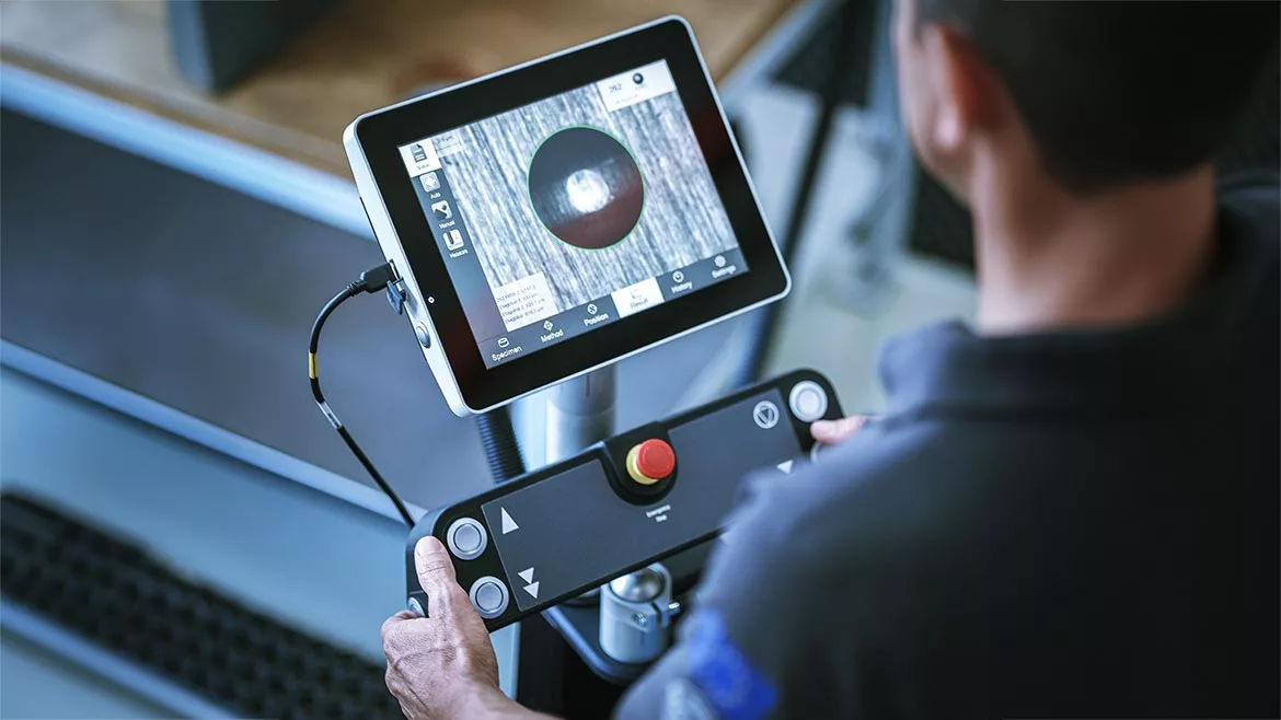

AI Evaluation for Brinell Testing with EMCO-TEST DuraVision.
AI Evaluation for Brinell Testing with EMCO-TEST DuraVision. Image Source: ZwickRoell

AI-Based Indentation Evaluation: Traditionally, automatic contrast detection was used to evaluate indentations, but this method had limitations. Surface scratches or marks often led to errors, and low-contrast impressions at high magnifications—such as those made with 100x lenses—could be difficult to interpret with accuracy. AI-based indentation evaluation addresses these challenges by using machine learning models trained on a wide variety of indentation types and conditions. This AI system can accurately evaluate indentations even in challenging conditions, making it possible to interpret high-quality hardness data despite potential surface imperfections.
Accurate Measurement of Test Points with AI-Based Evaluation
Accurate Measurement of Test Points with AI-Based Evaluation. Image Source: ZwickRoell
