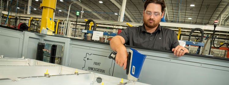

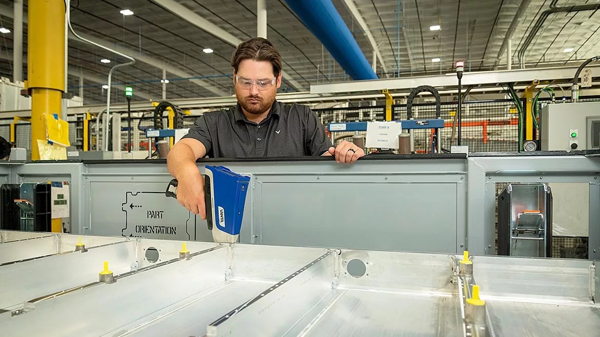

Handheld XRF analyzers are highly portable, enabling rapid and accurate elemental composition analysis and material identification on site. They can be precalibrated for a range of applications, including checking alloy grade specifications, the composition of glass or other materials, and layer thickness measurements of coatings. Easy to use and carry, fast and accurate, XRF handheld analyzers are the preferred method for thickness measurement of large parts, as they can be transported wherever they are needed.

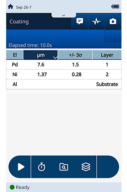

XRF analyzers can measure layers made of almost any elements, such as metals used for galvanization, electroplating, or nonchromate coating, as well as silicon against corrosion for example. In the analyzer’s user interface, users select the number of layers and their composition. A one-point calibration on a reference standard is recommended to tune the accuracy. Once calibrated the instrument is ready: simply place the analyzer on the sample to analyze, press the trigger and, in typically less than 30 seconds, the coating thickness is displayed on the analyzer screen.

Figure 2. Results screen from a handheld XRF analyzer displaying the thickness of palladium and nickel coating in an aluminum substrate. Image Source: Evident

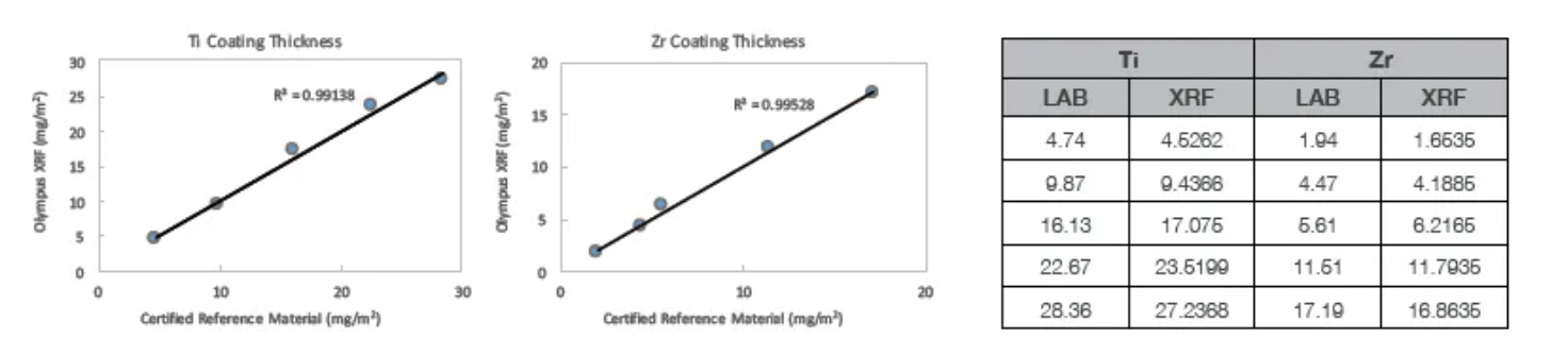

Titanium-zirconium (Ti-Zr)-based conversion coatings are used as an alternative to banned chromate coatings. Portable XRF analyzers can provide a rapid, nondestructive method to ensure that Ti-Zr-based conversion coatings have been applied and fall within the required thickness range. Data provided in Figure 1 illustrates the accurate coating thickness capabilities.
Figure 4. Ti and Zr coating thickness measurement accuracy. Image Source: Evident

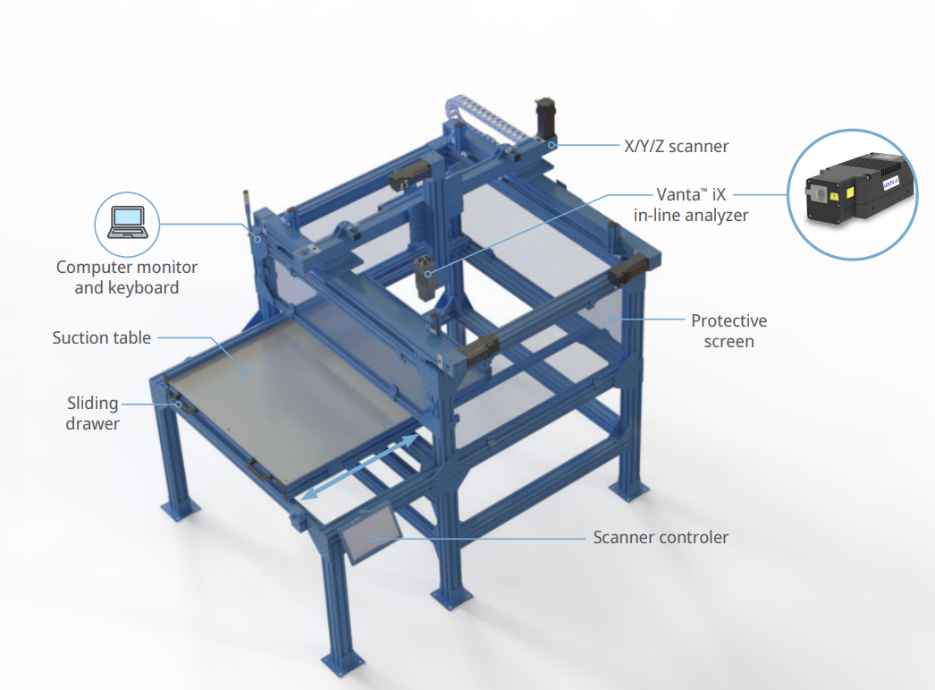

In-line XRF analyzers provide automated material analysis and coating thickness measurements directly on production lines. Using the same measurement principles as XRF handheld analyzers, they enable full inspection of coatings for metal part fabrication, films, glass and other components. Compact and rugged, they integrate easily with robot arms or 3D scanners to analyze large areas or to perform a large number of tests without human error. Measurement data is automatically shared with local databases and documented for complete quality control and traceability.
Figure 5. Automated XRF analyzer on a 3D scanner. Image Source: Evident
