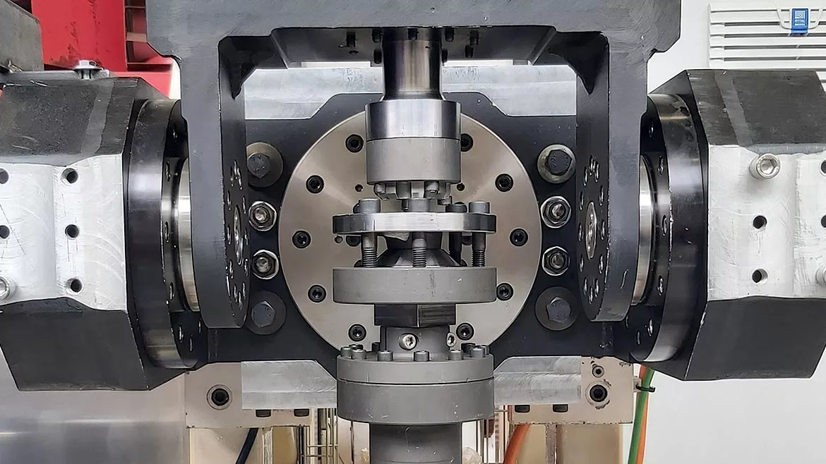

Belgian solutions integrator AHP Hydraulics carries the tagline of delivering “smart solutions in hydraulics.” Without question, the company’s small team has a history of delivering big results for clients. However, one client presented AHP with a certified stumper of a challenge.
The client, SIDEM NV, develops and produces automotive suspension and steering units. Ball joints play a critical role in these suspension units and thus require rigorous testing to ensure that production batches can be QA-approved and sent into supply. The client had a ball joint tester, but it wasn’t exact enough to meet the application’s needs, so they turned to AHP Hydraulics.
Sketch diagram of AHP’s proposed ball joint tester.
Sketch diagram of AHP’s proposed ball joint tester. Image Source: AHP Hydraulics
The ball joint test in question uses two hydraulically controlled axes: a horizontal (y-axis) and a vertical (z-axis), both with linear actuators, and both with electric torque axes. The hydraulic cylinders deliver position and force feedback into a programmable user-machine interface. The problem came down to precision and reliability.
“SIDEM NV commented that their existing system was not accurate enough,” says AHP Hydraulics automation engineer Ewout Reuman. They wanted a force tolerance of ±100 newtons over a total range of 6000 newtons. On the rotation, they specified a total tolerance of 0.5 degrees over a total range of 90 degrees while cycling at 4 Hz. “The rotational motion and the hydraulics had to be very accurate, and there I was on Google and YouTube trying to learn about the subject, quickly realizing how much I needed to pick exactly the right control product.”

AHP’s first step was procuring the client’s current ball joint tester and disassembling it into the mechanical parts. This allowed them to examine the electronics and consider how to improve the horizontal axis (y-axis) and vertical axis (z-axis) of hydraulic circuits and components. Ultimately, AHP rebuilt the tester from bottom to top and re-engineered the electronics and software. That included scrapping the conventional PC for motion control in the electrical cabinet and replacing it with a Beckhoff PLC functioning as the master and the Delta Motion controller as a slave for the hydraulics.
AHP’s Ewout Reuman found himself tasked with handling the ball joint tester’s electrical engineering and software programming. Once he understood the accuracy needed in the solution and why prior attempts had fallen short, he reached out to Delta Motion, which in turn led to Delta sending a representative to Brussels to work alongside the AHP team in understanding the system’s challenges and how to solve them.
AHP procured Delta’s RMC75E dual-axis motion controller with Ethernet connectivity for communication with the system’s master PLC. Reuman paired this with Delta’s MA2 magnetostrictive I/O module and the AP2 analog I/O module for measuring force feedback from load cells.

The nature of the directional forces within the apparatus led to some vexing challenges. Imagine the central ball joint continually rotating back and forth within its housing while being pushed on both from the side and below, all while a boom allowed the ball joint to swing back and forth, and the give within that joint housing allowed the ball to be constantly off-center. With these multiple forces all interacting, there was never a perfect center state; the system was always in a state of deviation and change. Asynchronous force testing was always inaccurate. That alone was something AHP’s client could accept, but the deal breaker was the system’s propensity to show force steadily growing over time. The customer demanded that asynchronous force be stable.
“I tuned my axes to specific frequencies, force amplitudes, and oil temperatures and the specific supply pressure for the pump and accumulators,” says Reuman. “But our setup is highly dynamic—the operator can select any combination from 0 to 6000 Newtons and 0 to 4 Hertz. Environmental factors also play a role. For example, if the power unit is located outdoors, weather conditions ranging from -30°C to +40°C will impact oil viscosity during test runs. To address this, we installed both a heater and a cooler. However, at the extremes of this temperature range, the system may struggle to maintain the setpoint consistently.”
“Going into the project,” he adds, “I wasn’t aware how much influence that would have. I would get immense overshoots and undershoots, so I was constantly retuning the system when test frequencies, amplitudes, or oil temperature changed.”

The situation called for rethinking the tuning. Delta suggested that adaptive amplitude control could fix AHP’s precision and reliability. AHP could measure every sine wave cycle and compare it to the target. Then the controller adjusts the amplitude and offset for the following sine wave cycle until the target and actual forces coincide.
Graph of asynchronous AHP ball joint test data for the Fz (vertical push/pull) axis. Note the rise and fall in the wave peaks.
Graph of asynchronous AHP ball joint test data for the Fz (vertical push/pull) axis. Note the rise and fall in the wave peaks. Image Source: AHP Hydraulics
Taking inspiration from Delta’s sample projects, Reuman identified a repeating wave pattern in the force curve. While the sample project provided the foundation for implementing adaptive amplitude control, Reuman added the wave pattern solution he developed. If all axes were synchronous, then the peaks would be flat. Based on the input frequencies, Reuman used Delta’s RMCTools software to identify the wave pattern in the wave crests and troughs and arrive at a method of offset and amplitude gains to compensate for it. For example, if the highest peaks occurred with every fourth wave, then the instance of one peak wave could inform how to compensate for the next fourth peak. (In reality, Reuman ultimately compensated for every sixteenth peak.) This dynamic approach proved far better than AHP’s previous approach of applying one set of offset and amplitude gain values for every wave. With wave peaks brought back within acceptance tolerances, AHP could successfully use PID control to control force between the peaks and thus rectify that runaway force growth.
This combination of adaptive control and PID tuning was the missing key that allowed AHP to succeed with its ball joint tester.
With some fine-tuning, Reuman easily mapped the changes he worked out in RMCTools to his own application. No additional sensors or other equipment were needed to successfully implement adaptive control. It simply dropped into place via software.
