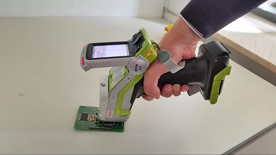

Figure 1: (A) Niton XL5 Plus and Circuit Board, (B)  FT-IR spectrometer (Thermo ScientificTM NicoletTM Summit TM X Spectrometer
Figure 1: a) Handheld XRF analyzer (Thermo ScientificTM NitonTM XL5 Plus Handheld XRF Analyzer) analyzing components on printed circuit board b) FT-IR spectrometer (Thermo ScientificTM NicoletTM Summit TM X Spectrometer) with an ATR accessory (Thermo Scientific™ Everest Diamond ATR Accessory). Image Source: Thermo Fisher Scientific

Modern handheld XRF analyzers can detect and measure the total concentration of elements regardless of their oxidation state, with atomic numbers ranging from magnesium (12) to uranium (92) in diverse types of materials such as metals and alloys, ceramics, glass, minerals, or plastics. Therefore, the technology is adequate to determine the concentration of heavy metals, including Pb, Hg, and Cd, and to provide the total concentrations of Cr and Br, which are excellent indicators for the presence of respectively hexavalent chromium and brominated flame retardants such as PBB and PBDE. The screening workflow for handheld XRF according to the international standard IEC 62321 [1] is shown in Figure 2. Depending on the Cd, Pb, Hg, Cr, and Br levels, the specimens are classified into three categories: RoHS-compliant (pass), RoHS-non-compliant (fail), or inconclusive. Samples with inconclusive results should be further analyzed using laboratory techniques.
One key benefit of the technology is the ability to work in point-and-shoot mode and generate results in seconds. Furthermore, the instruments are fully portable and can be brought to receiving docks, warehouses, product assembly, or retail stores for on-site screening. Modern handheld XRF analyzers are also easy to operate by non-experts: the instruments are delivered pre-calibrated and ready to use for the analysis of different types of materials (metals, ceramics, inorganic, plastics), and an algorithm automatically recognizes the type of material and selects the adequate measurement parameters and calibrations. Figure 2 shows some examples of analyses: the handheld XRF analyzer accurately identifies a first specimen as PVC-plastic. It does not detect any regulated element above the threshold and displays “Pass.” In contrast, it identifies a second specimen as metal (solder SAC 305) containing Cd above the threshold (± uncertainty) and therefore displays “Fail.”
Although the analysis is fully nondestructive, the operator may require disassembling the product when a homogeneous unit cannot be isolated using the standard (diameter 8 mm) or the small (diameter 3 mm) measurement spot. For better ergonomics, small-sized samples or electronic parts such as printed circuit boards (PCBs) can also be analyzed using a test stand, which converts the analyzer into a small benchtop unit and provides laboratory-like conditions.
Using handheld XRF, manufacturers, importers, and retailers can implement a standardized screening protocol according to IEC 6232-3-1 [2] or ASTM F2617-15 [3] to verify compliance with electronic and electric devices and reduce the chances that non-compliant products will enter the manufacturing process or reach the store shelves.
