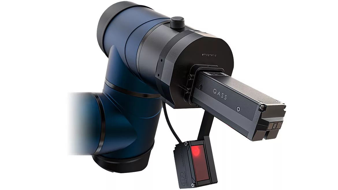

In the context of magnetic measurement, the main advantage is the statistical significance of the measurement result. Test frequencies (F) of the magnetic field are from 100 Hz up to 4,000 Hz. There are 2*F measurements of a material per second. The measurement can be stationary or under motion and quickly generates an effective number of measurements. The statistically determined deviation at a measuring point is less than 2 percent.

In our case, in the FFT representation, the area of a signal pair correlates with the twofold magnetization of a material. Physically, the magnetic hysteresis is traversed. The area of the hysteresis represents the performed magnetic work. Mechanical and technical properties of a material are determined from the image data.
The repeated remagnetization results in numerous measurement repetitions for a material location. These measurement repetitions can be superimposed. In this case, all measurement repetitions of hysteresis runs are combined into a single pair of Barkhausen hills. This allows statistical measurement deviations to be minimized. In addition, outliers and interfering influences can be detected and eliminated.
The method can also be used for moving measurements. In this case, the superposition is calculated for short time intervals. For each time interval a representation of the hysteresis run is generated. The size and overlap of the time segments can be parameterized to match the speed of movement.
