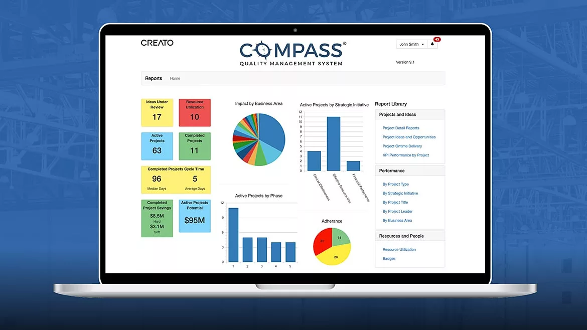

Once you have implemented a competent quality module or system, it will provide an organization with data that can mature a continuous improvement program. As that program grows, you may consider quality management software that tracks the implementation of your improvement projects. At Leonardo DRS, one of the largest defense contractors in the world, the company’s QMS has verified $48M in project ROI with another $44M in the works.

As each organization may take a different path to improvement, the flexibility of the system, as evidenced by degree of customization offered, is critical. You should not have to change the way you do business simply because you licensed a new application. Instead, the application should adapt to your existing processes.
Generally, the buyer would be well-advised to know the difference between a product that is little more than an Excel-inspired spreadsheet versus a product designed from the ground up to accommodate your business requirements. The spreadsheet design may look tempting because it is familiar to you. Still, these products’ depth and the interfaces offered may be limited if they have built their product on an Excel platform. Like any software procurement exercise, begin with a list of functional requirements and use sites like G2 and Capterra to narrow the field of qualified choices.
