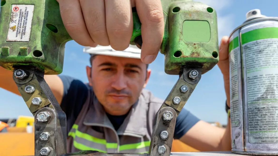

Yokes are some of the most versatile and trusted pieces of MPI equipment when you are out inspecting in the field. They also come in a variety of shapes and sizes, which means some yokes are more suited to your needs than others.
Choosing the right yoke makes a tremendous difference to the inspector who is going to be using it over 8 hours a day under difficult conditions. Here are five things to consider when choosing the right yoke for the job.
1. WEIGHT
How heavy does the yoke feel in your hand? Try holding it for more than a few minutes and ask yourself the same question.
Not all yokes are weighted equal; some yokes are almost twice as heavy as others. When you are using a yoke all day, a heavier yoke can slow you down by 15% and cause fatigue. This is especially true if you are inspecting surfaces overhead or in difficult to reach areas.
Another factor to check is if the weight is equally distributed across the yoke. Is the yoke bottom heavy? That could make it difficult to inspect sideways. Some yokes can cause wrist strain when used at awkward angles. Others may require the use of two hands to hold the yoke steady – effectively needing a second operator to disperse the powder.
A bottom-heavy yoke essentially becomes cantilevered when holding sideways, which requires more force at the handle to stabilize. A lightweight, balanced yoke is the best choice if you are inspecting for longer periods, and for overhead or hard-to reach areas.
