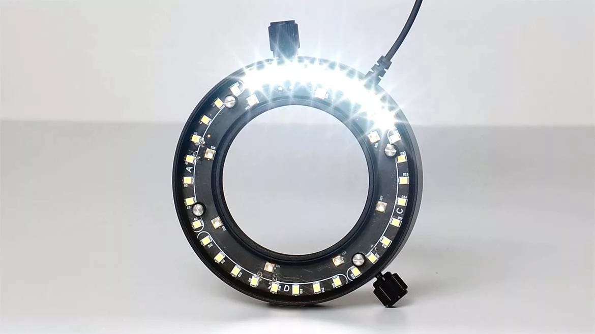

This item is a 56-LED Microscope Ring Light designed to provide focused, shadow-free illumination for stereo microscopes and industrial inspection.
Image Credit: Inspectis
Fig 1: A modern White/UV ring light with 32 white LED:s arranged in 4x8 segments and 8 high intensity UV LED:s from Inspectis.

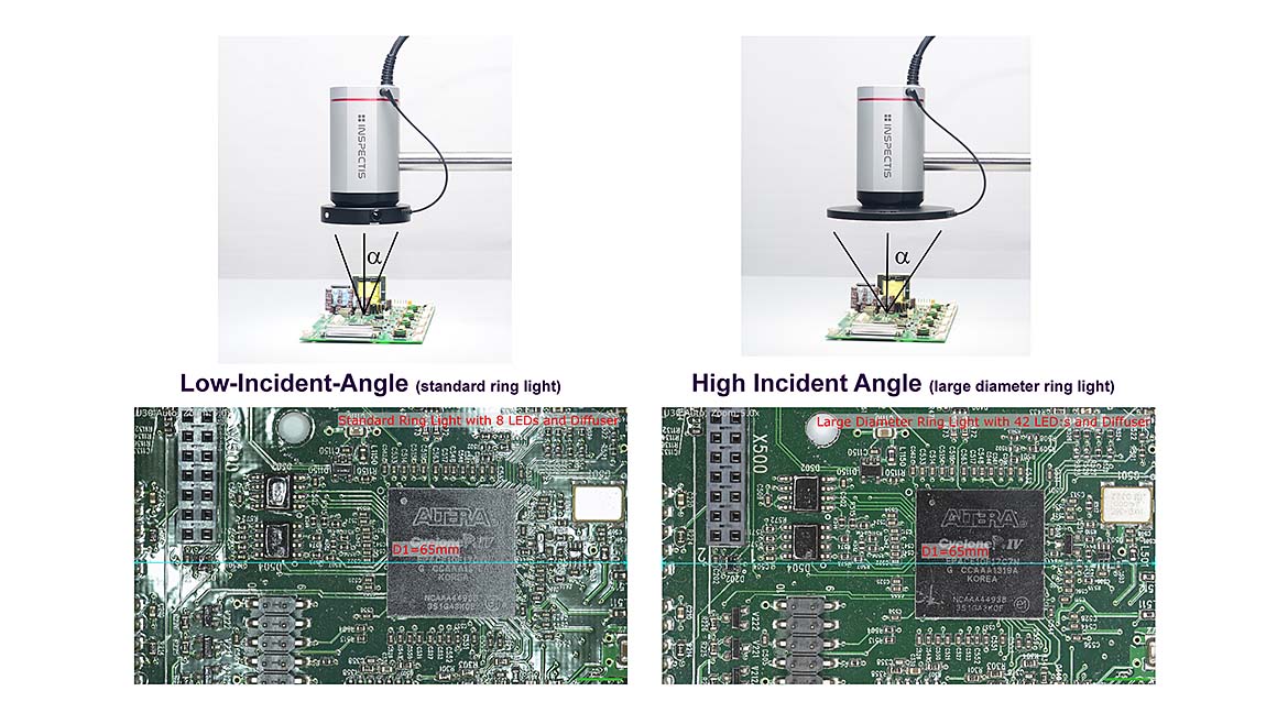

Illumination Angle, an Underestimated Parameter
The angle of incident light rays has a direct impact on the image quality and appearance of the inspection objects, especially electronic circuit boards. It determines the level of unwanted reflections and/or glare from the shiny surface of the inspection object and dictates which specific defects become visible.
Low-incident-angle ring lights e.g. a small-diameter ring light with LEDs close to the lens provide uniform and shadow-reduced light from all sides. It works well for illuminating matte surfaces but creates glare from shiny surfaces. In most cases it offers a balanced illumination for general overview and quality control of components and solder joints in assembled electronics boards, but at higher zoom factors (low field of view).
The image displays a comparison between two different types of ring lights used for industrial inspection on a printed circuit board.Fig 2: Image of a PCBA with standard and large diameter ring lights and their impact on the image of PCBA.
High-incident-angle lighting e.g. ring light with a large diameter and LEDs far from the lens, reduces glare and allows working with larger field of views. Although this lighting is very soft and, it emphasizes height and texture; revealing raised leads, cracks, uneven solder paste, and surface irregularities.

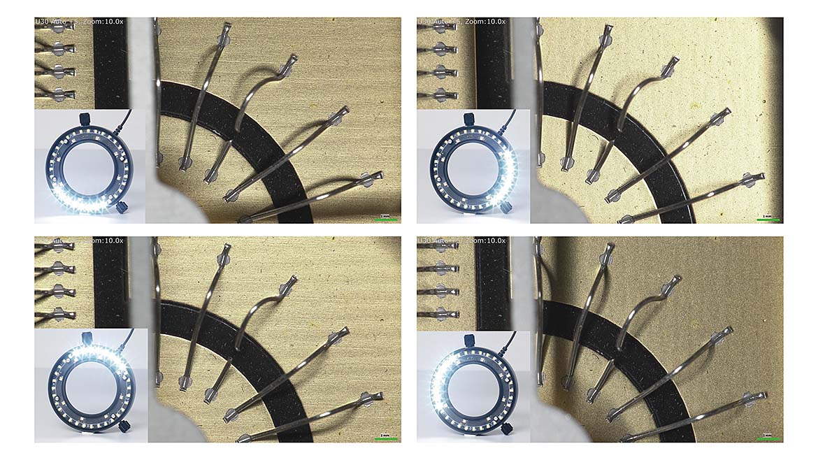

Light Direction by Segment Control
Direction of incident lighting determines the interplay of highlights, shadows, and reflections on the PCB’s 3D topography. Changing the direction changes the visual information you receive.
The item pictured is a NeoPixel LED Ring LightFig 3: Impact of segment lighting on the image of bonds.
Four-segment ring lights add directional control to standard ring light benefits, allowing you to manipulate shadows and highlights to reveal different defect types. The incident oblique light from each segment creates long shadows that emphasize the height, texture, scratches, lifted leads and edge details, perfect for revealing 3D defects especially at high image magnifications.

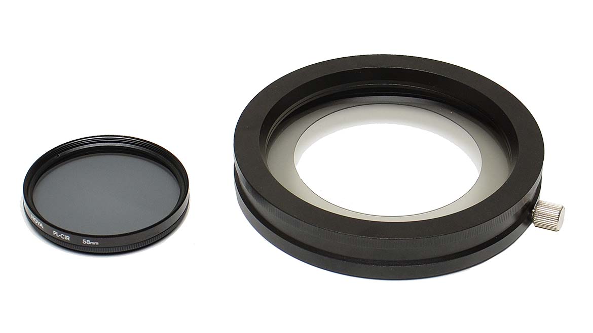

Why Polarization Filter?
Illumination with polarization technique eliminates unwanted glare and reflections. Its primary impact on PCB inspection is to reveal surface detail and material properties hidden by specular reflections from glossy or metallic surfaces.
This is a polarizing set for a digital microscope ring lightFig 4: Polarizing filters for Ring Light and lens.

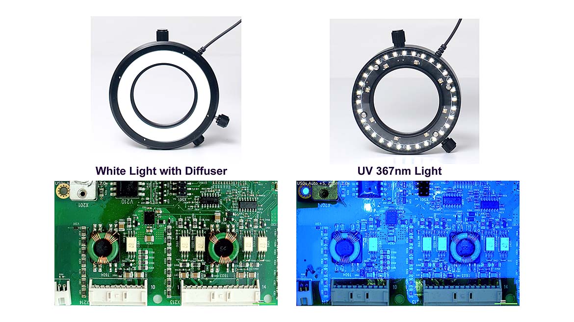

Do you need UV for Fluorescence Lighting?
For conformal coating inspection, a UV-A light source, typically at 360-370nm wavelength is required to make the coating fluoresce for thickness and coverage checks. Using an integrated white/UV-A ring light offers significant benefits by combining two essential inspection modes into a single, efficient tool. The core advantage is that it allows for a faster, more accurate, and streamlined quality control process.
This item is a Microscope LED Ring Light designed to provide uniform illumination for microscopic examination. Fig 5: Image of a PCBA with conformal coating illuminated by a dual white- and UV ring light from Inspectis.
