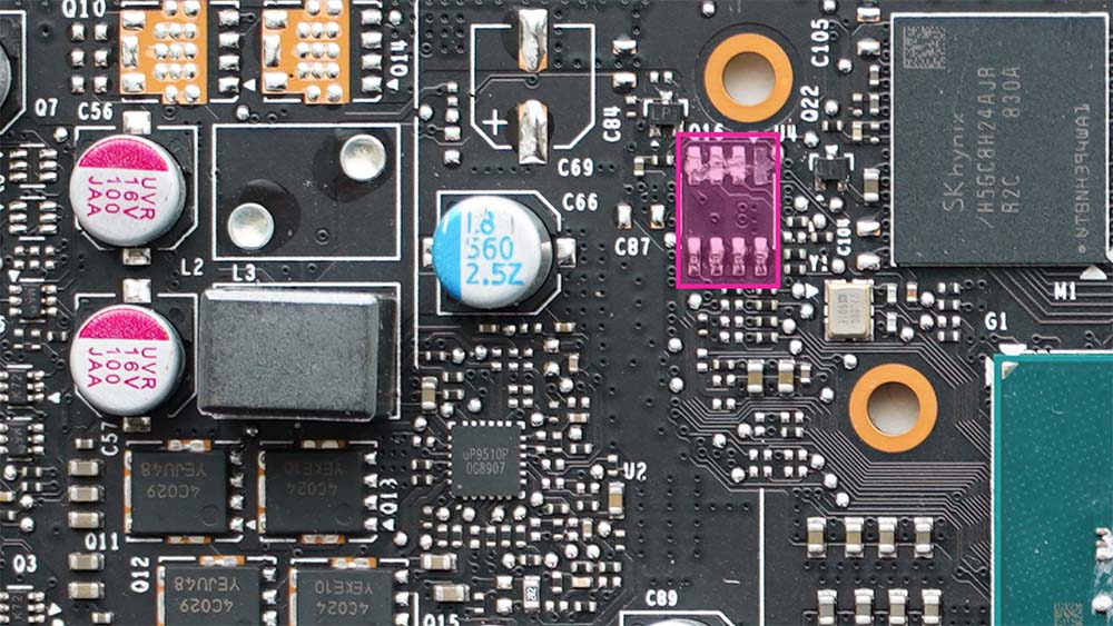

Missing Components
Assembly inspections, as seen in PCBs, are an ideal candidate for visual AI training. Image Source: TAGARNO
Good candidates for visual AI training include:
  • Surface defect detection: Scratches, pits, cracks, or discoloration on components where the exact shape or size of the defect can vary.
  • Assembly verification: Confirming whether all required parts are present, aligned, or soldered correctly on small-scale assemblies like PCBs.

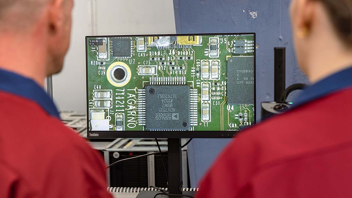

Two men looking at monitor screen using visual AI.
Just as with people, visual AIs need to be trained. Image Source: TAGARNO

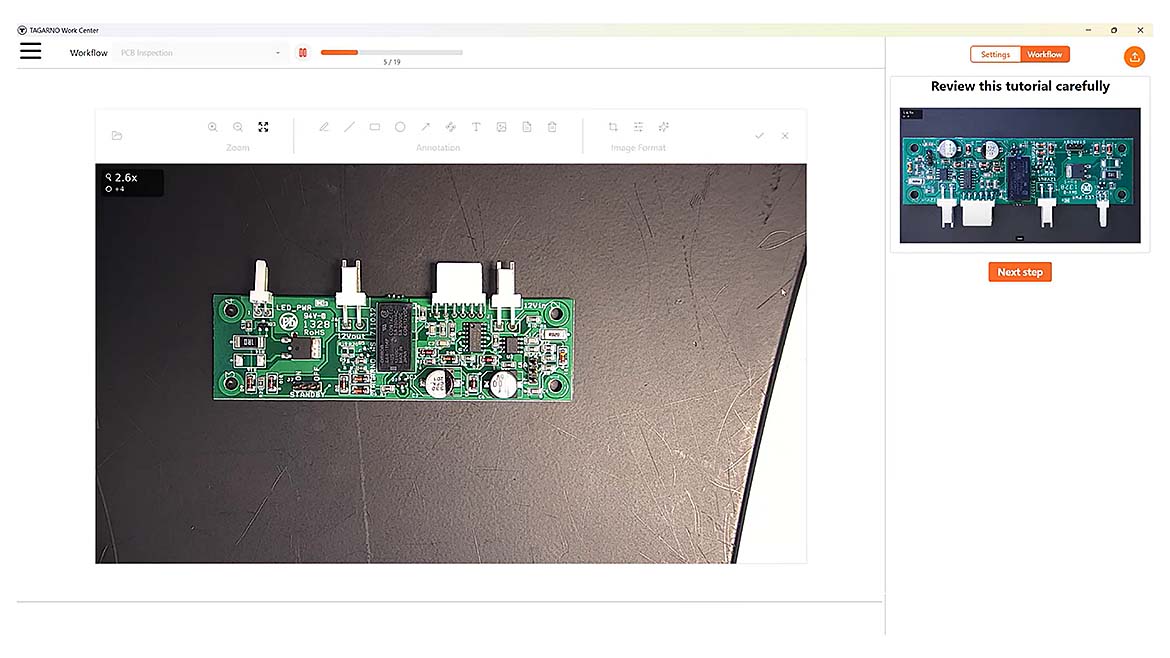

Work-center demo high-res
Seamless, real-time integration of AI and work instructions directly into the existing quality process. Image Source: TAGARNO
Practical integration strategies include:
  • Overlay suggestions and training directly on microscope images into your existing quality process
    Instead of pulling operators into separate interfaces, AI results can be displayed in real-time on the microscope screen—highlighting suspected defects or confirming pass/fail decisions. Putting this inline into an already existing quality control process allows significant amounts of training data to be generated without requiring an entirely separate process to train an AI.
