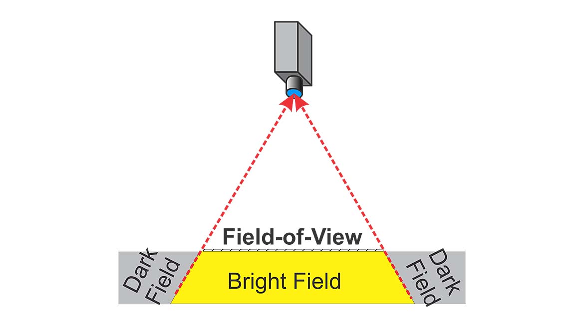

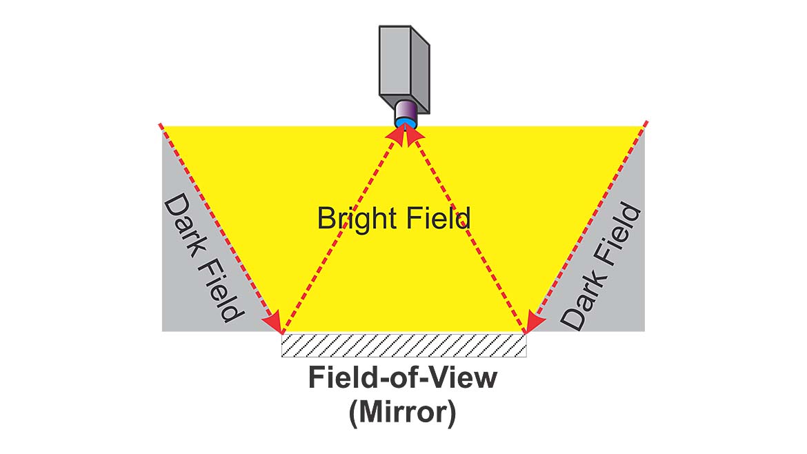

Bright Field or Dark Field
There is the concept of the illumination “W” for front lighting. If lines are drawn from the center of the lens to the edges of the field-of-view, and then continued as if they were reflected off a mirror, the lines form the shape of a “W”. When the light source is inside the illumination “W”, it provides bright field illumination. When the light source is outside the illumination “W”, it provides dark field illumination. (See Figure 3.)
The diagram illustrates the difference between bright field and dark field illumination techniques in machine visionFigure 3 – Illumination “W” and Bright Field and Dark Field Lighting Regions - Image Source: Perry West
For back lighting, the “W” turns into an inverted “V”. Light within the “V” is bright field, and light outside the “V” is dark field. (See Figure 4.)
The image illustrates the principles of bright field and dark field illumination in machine visionFigure 4 – Illumination “V” and Bright Field and Dark Field Back Lighting Regions - Image Source: Perry West
The third article in this series will show that the characteristics of the scene can affect the shape of the “W” or “V” as well as make the demarcation between bright and dark field very crisp or very blurry.

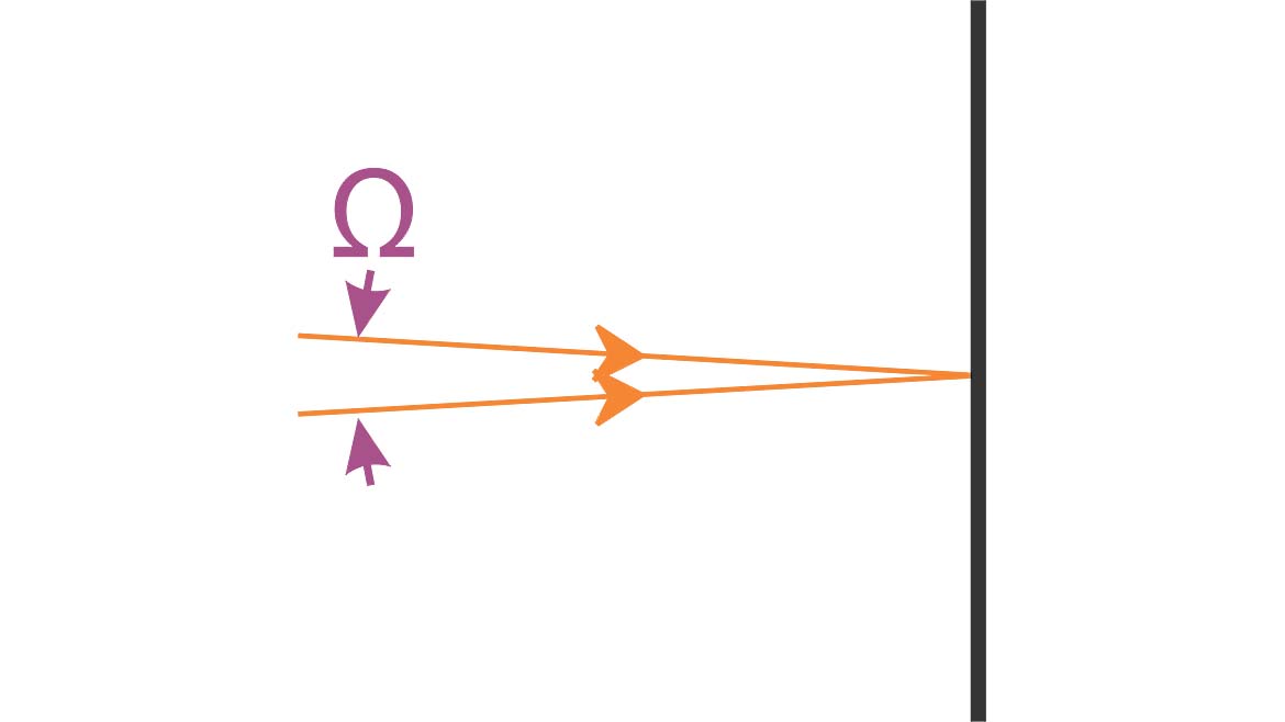

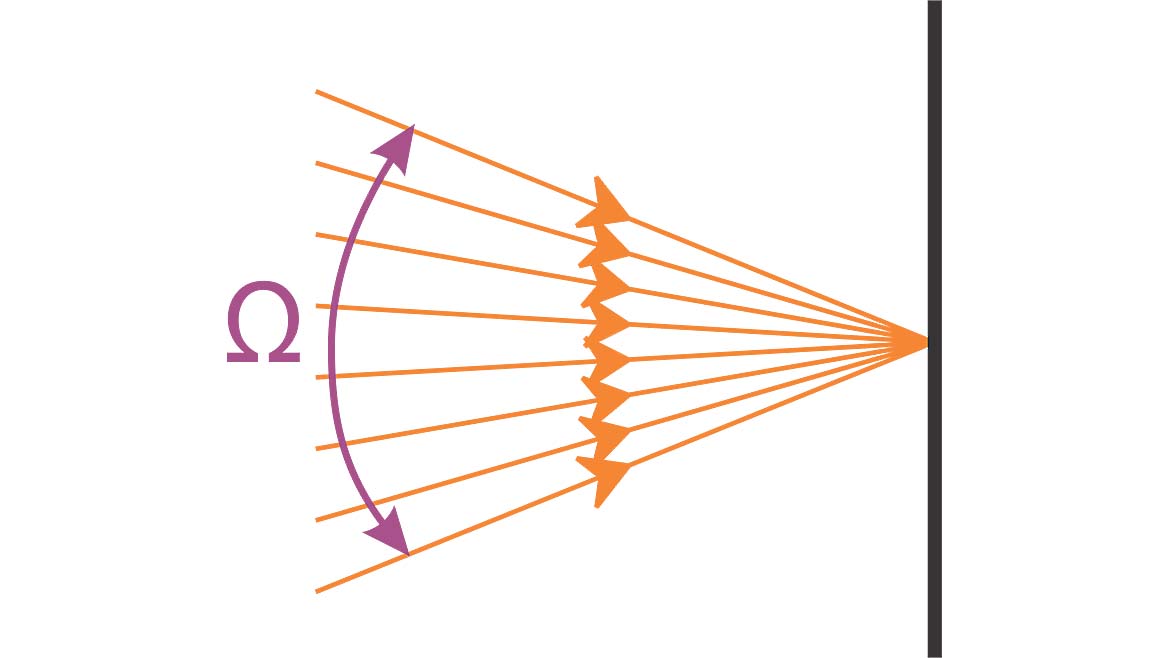

Diffuseness is also a property of incident light as well as reflected light. When incident light arrives at a point in the scene from a very narrow range of angles, it is direct illumination. (See Figure 5.)
The image illustrates a convergent beam of light, where light rays travel towards a single focal point. Figure 6 -- Diffuse Illumination - Image Source: Perry West
Direct illumination casts strong, distinct shadows. When incident light arrives at a point in the scene from a very wide range of angles, it is diffuse illumination (see Figure 6). Diffuse illumination provides very indistinct shadows or sometimes no shadows at all.

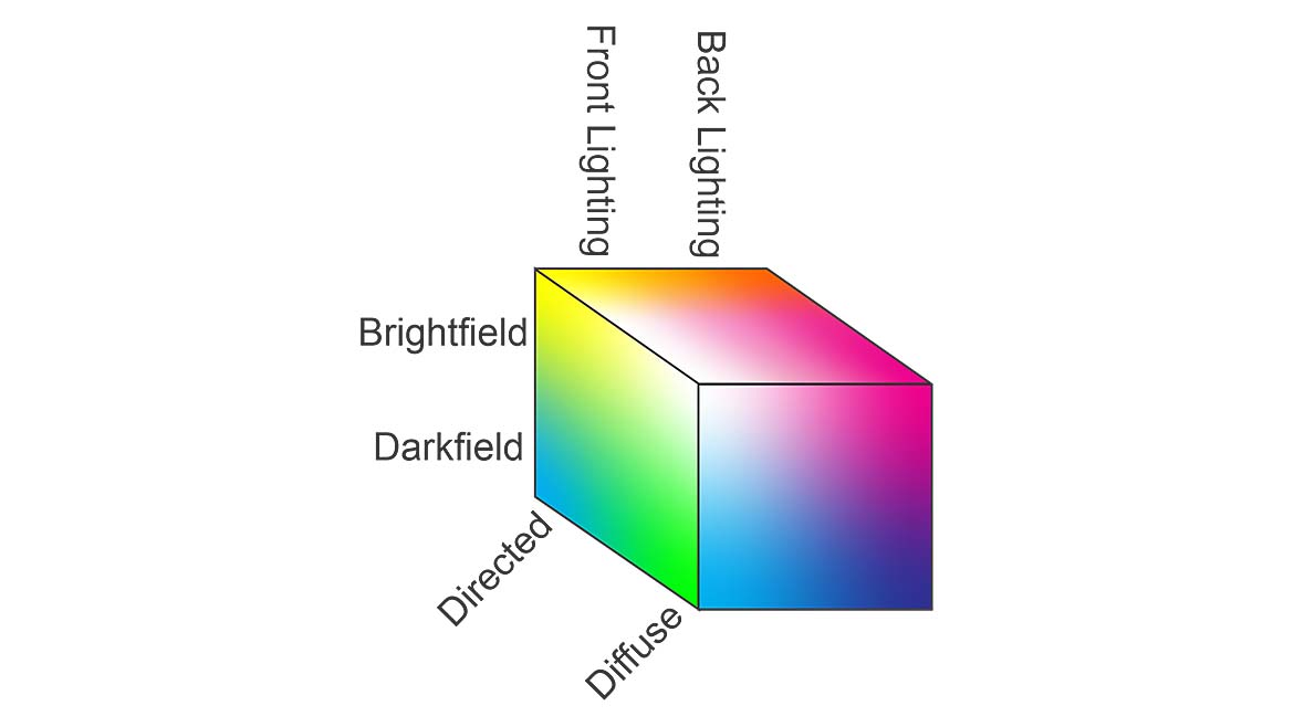

The Lighting Cube
The first three pairs of characteristics above all relate to light direction and can be shown as a cube with axes of Front Lighting/Back Lighting, Bright Field/Dark Field, and Direct/Diffuse. (See Figure 7.)
The image displays a "Lighting Cube," a model used in machine vision to classify different types of illuminationFigure 7 -- The Lighting Cube - Image Source: Perry West

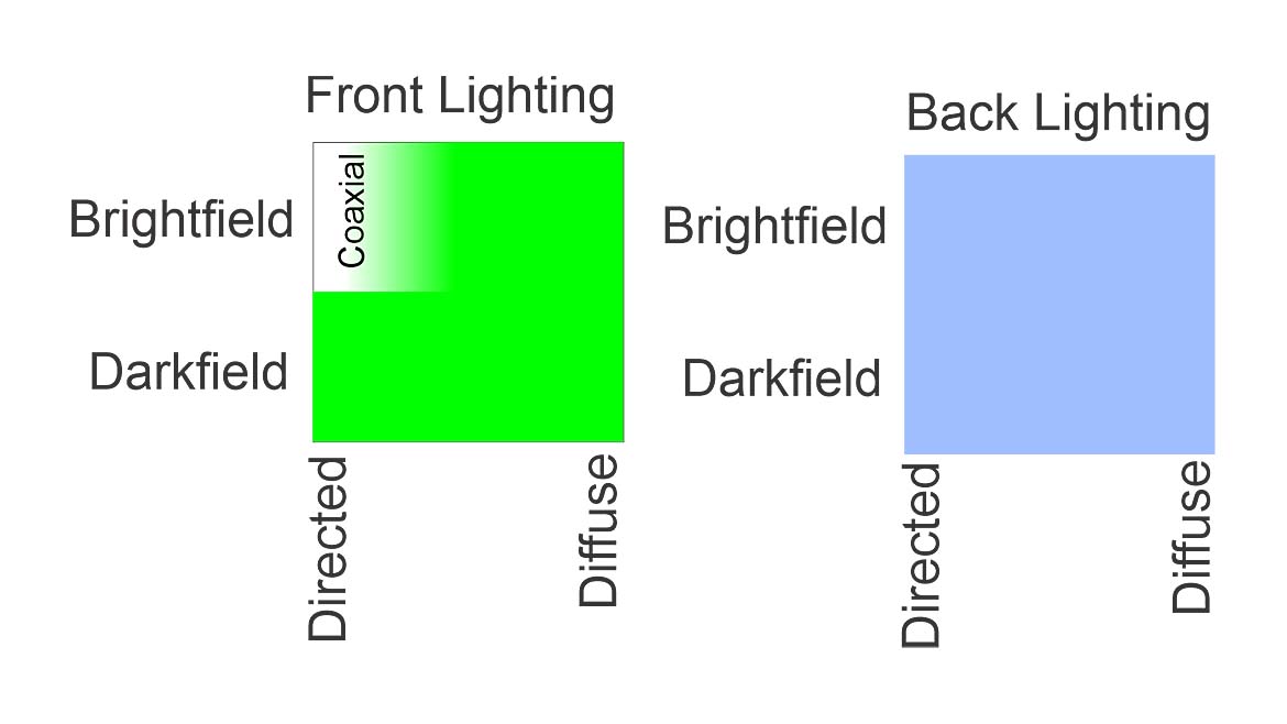

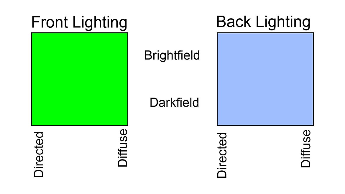

Since front lighting and back lighting are mutually exclusive, the lighting cube can be simplified into two rectangles: one for front lighting and the other for back lighting. This is shown in Figure 8. The two halves together are still referred to as the lighting cube for simplicity.
While the lighting cube represents the directional characteristics of machine vision illumination, it doesn’t address dimensional requirements. It doesn’t address the size of the light source to be appropriate for the size of the field-of-view. It also doesn’t address working distance restrictions that affect which lighting techniques and sources are compatible with an application.
The image displays a diagram illustrating different lighting techniquesFigure 8 -- Two Halves of the Lighting Cube - Image Source: Perry West

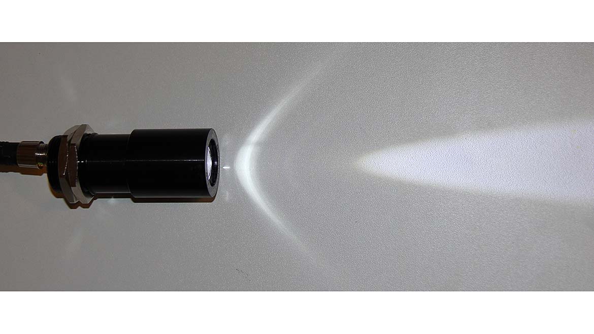

Spot Light
The light source that most often comes to mind is the spot light. (See Figure 9.)
This is a Smart Vision Lights SXA30 series adjustable spot lightFigure 9 -- Small Spot Light - Image Source: Perry West
This is a light that has its light focused on a limited area, is fairly direct, and casts strong, distinct shadows. While used occasionally in machine vision applications, its drawback is that it usually provides light with poor uniformity across the field-of-view unless it is used with a long working distance from the field-of-view.

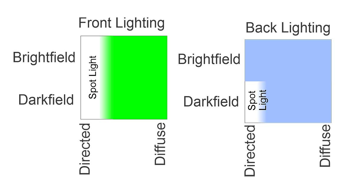

Figure 10 shows the spot light mapped onto the lighting cube. The white areas are its areas of best use. The colored areas are where it is not generally appropriate.
The image displays two diagrams illustrating different lighting techniquesFigure 10 -- Spot Light Mapped onto the Lighting Cube - Image Source: Perry West

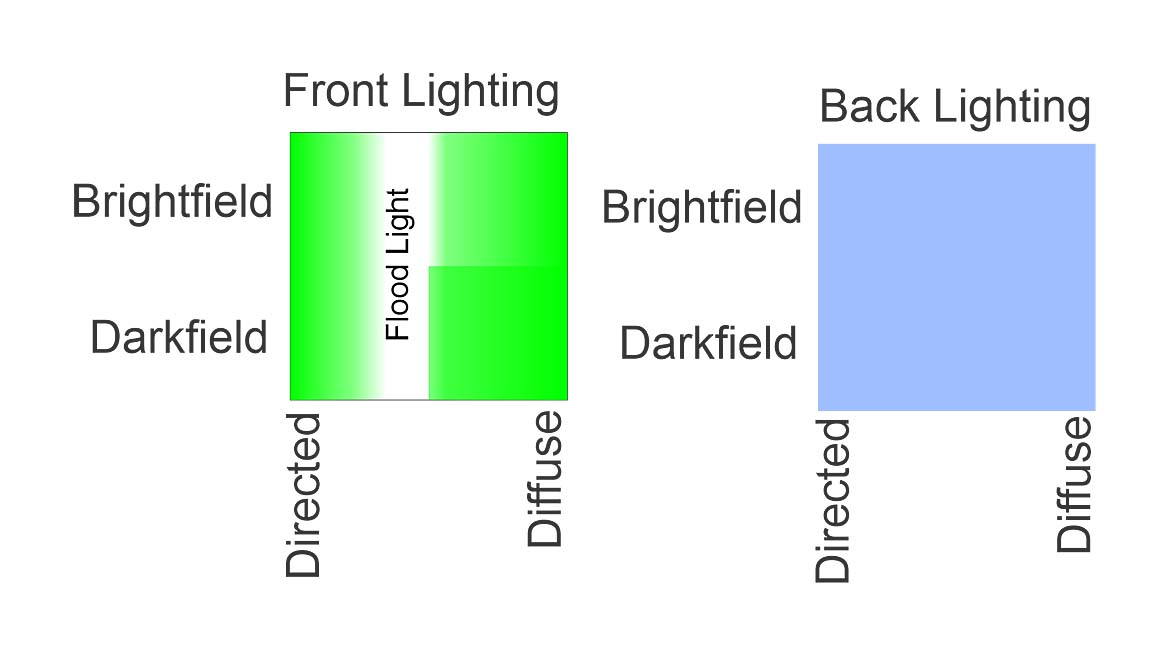

Flood Light
A flood light (see Figure 11) is designed to flood an area through a range of angles, making its light somewhat diffuse. The flood light produces soft shadows. Because they are designed to illuminate a large area, flood lights are used occasionally for very large fields-of-view. However, in this use, they may give illumination with some non-uniformity across the field-of-view.
This is a LUMIMAX® LQHP80FL-16-W-100 LED area flood lightFigure 11 -- Flood Lamp - Photo by LUMIMAX by Exaktera
Figure 12 shows the flood light mapped onto the lighting cube. Notice that there is no mapping for its use as a back light since the light is unsuitable for this application.
The image displays two charts contrasting different types of lighting techniquesFigure 12 -- Flood Light Mapped onto the Lighting Cube - Image Source: Perry West

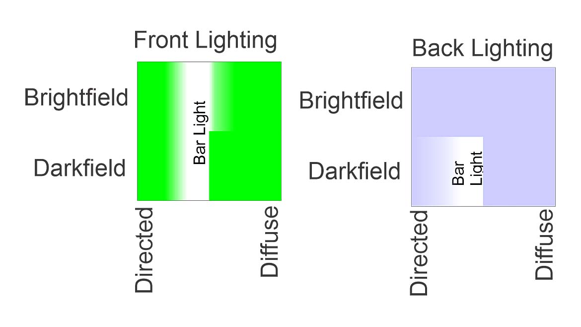

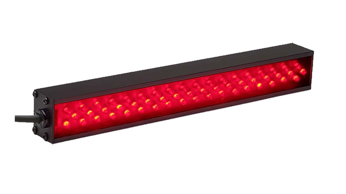

Bar Light
The bar light is a form of a flood light. (See Figure 13.) Because of its rectangular format, it is very diffuse in its long dimension and only somewhat diffuse in its narrower dimension. This light is finding frequent use in machine vision applications.
This is an LED bar light for stage or machine vision applicationsFigure 13 -- Bar Light - Photo by Advanced Illumination
Figure 14 shows the bar light mapped onto the lighting cube. Because of its geometry, it does find some application as a dark field back light.
The image illustrates different lighting techniques used in machine vision and photography, specifically comparing front lighting and backlighting applicationsFigure 14 -- Bar Light Mapped onto the Lighting Cube - Image Source: Perry West
Something is becoming evident in this mapping. The lower right corner is masked off. The masking identifies that a dark field light source cannot be highly diffuse. If it were highly diffuse, it would encroach into the bright field area.

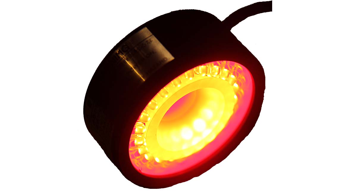

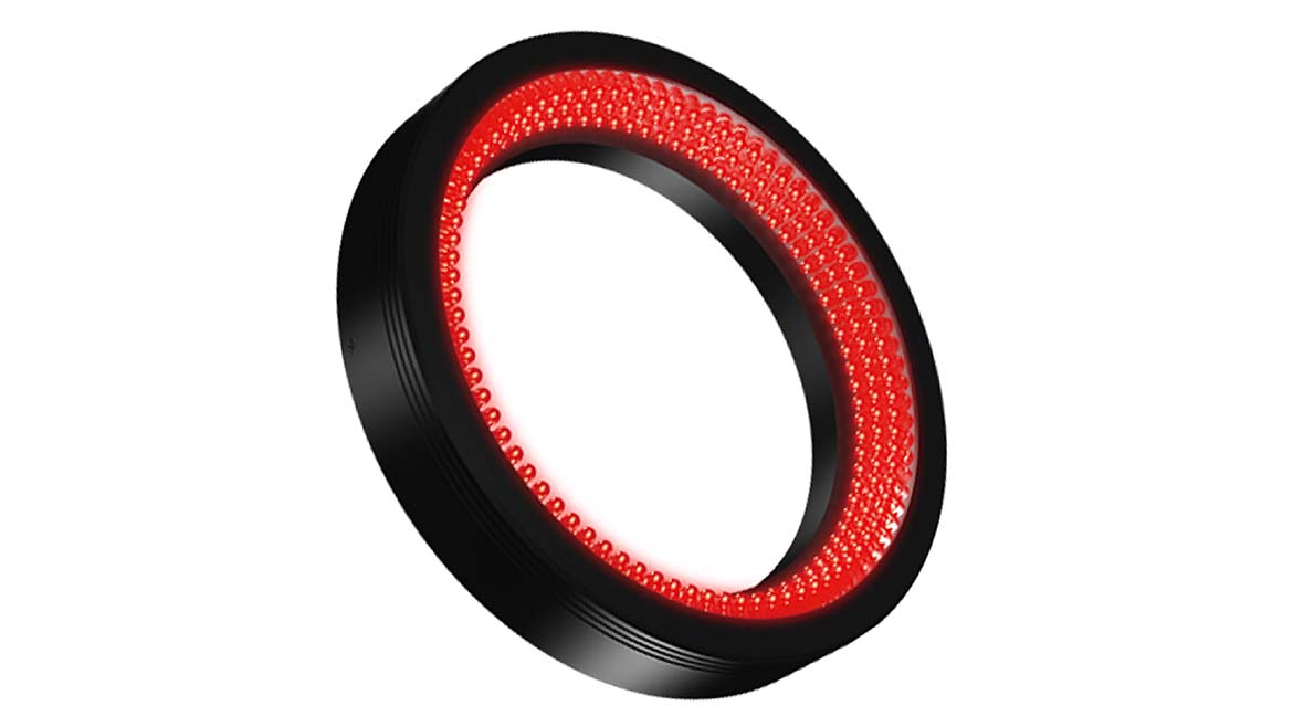

To give the best uniformity, ring lights are designed for either bright field (Figure 15) or dark field (Figure 16) illumination. Bright field ring lights have their LEDs aimed more axially along the ring light’s axis. Dark field ring lights have their LEDs aimed more radially toward the ring light’s axis.
This is a low-angle red LED ring light used for industrial machine vision applicationsFigure 16 -- Dark Field Ring Light - Photo by CCS

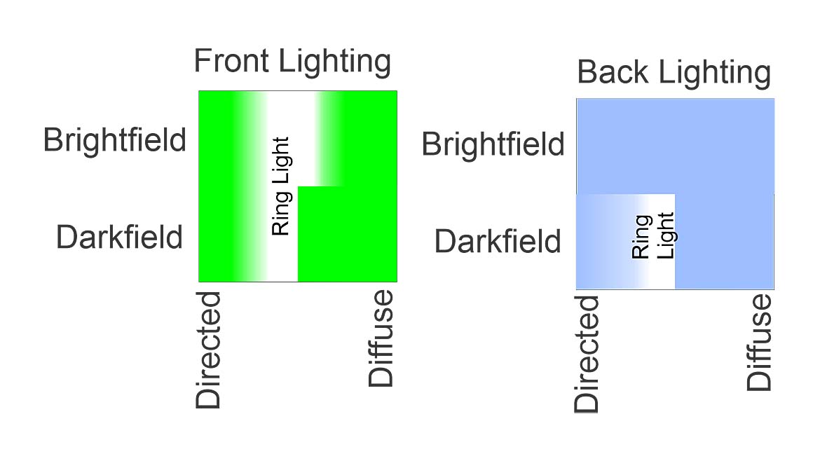

Note that ring lights are designed to give the best performance not only from bright or dark fields but also for a certain range of fields-of-view sizes and a certain range of working distances. The information in these articles will help you identify if a ring light is right for your application. It will not serve as a provider of the specifications of the right light.
Figure 17 shows the ring light mapped onto the lighting cube.
The image displays a chart comparing different types of lighting based on whether they are front or back-lit, and directed or diffuse. Figure 17 -- Ring Light Mapped onto the Lighting Cube - Image Source: Perry West

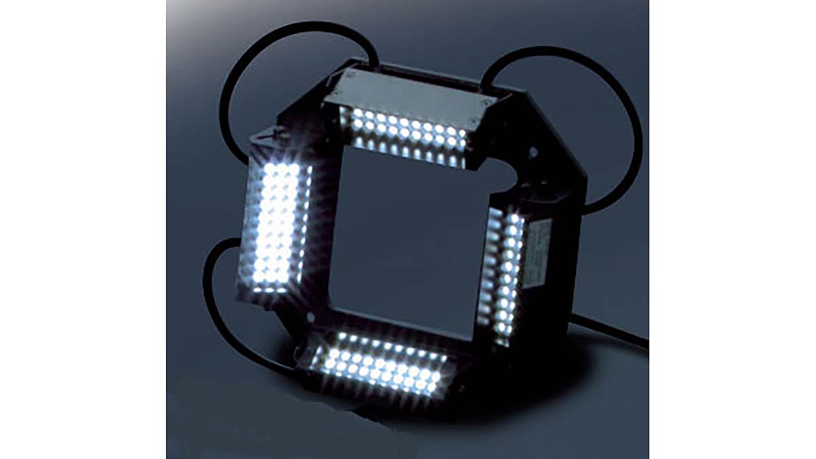

Another form of ring light is created using several bar lights; typically, four bar lights are shown in Figure 18. The advantage of this configuration is that it allows adjustment of the angle of the bars to give the best (most uniform) illumination.
This is a modular LED machine vision ring light, such as the WenglorTPL Modular-RING 80mmFigure 18 -- Four Bar Lights as a Ring Light - Photo by Moritex

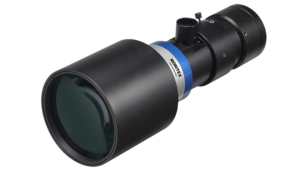

Coaxial illumination is illumination provided on-axis with the imaging lens. Most often, coaxial illumination is built into the lens. Macro lenses and telecentric lenses are available with built-in coaxial illumination.
Telecentric lens coaxial illuminators provide very directed illumination. The illumination is direct and parallel with the optical axis of the lens.
This is a Moritex MTL series bi-telecentric lens, used in industrial machine vision applicationsFigure 19 -- Macro Lens with Coaxial Illumination Port - Photo by Moritex
Macro lenses having coaxial illumination (see Figure 19) may be partially diffuse for high-magnification macro lenses or provide more directed light from many low-magnification macro lenses.

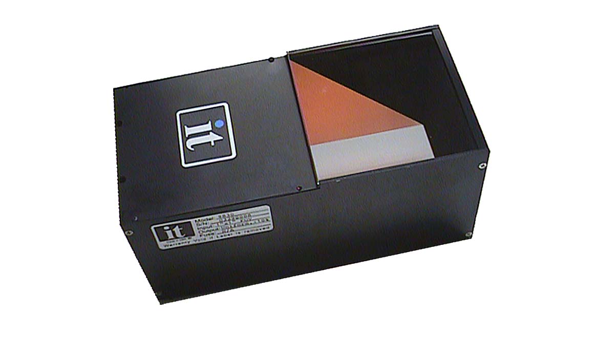

Coaxial Diffuse Illuminator
A light source that is external to the lens but still coaxial is the coaxial diffuse light source shown in Figure 21. This illuminator is normally placed just beneath the lens. The light from an array of LEDs is transmitted through a diffuser and reflected off the beamsplitter onto the scene. Light from the scene passes through the beamsplitter to reach the camera’s lens.
The image shows a HID ATOM (formerly Access-IS ADR300) document readerFigure 21 -- Coaxial Diffuse Illuminator - Photo by Illumination Technology
The coaxial diffuse illuminator maps onto the lighting cube as shown in Figure 21. Note that the coaxial diffuse illuminator has no purpose for either dark field lighting or back lighting.

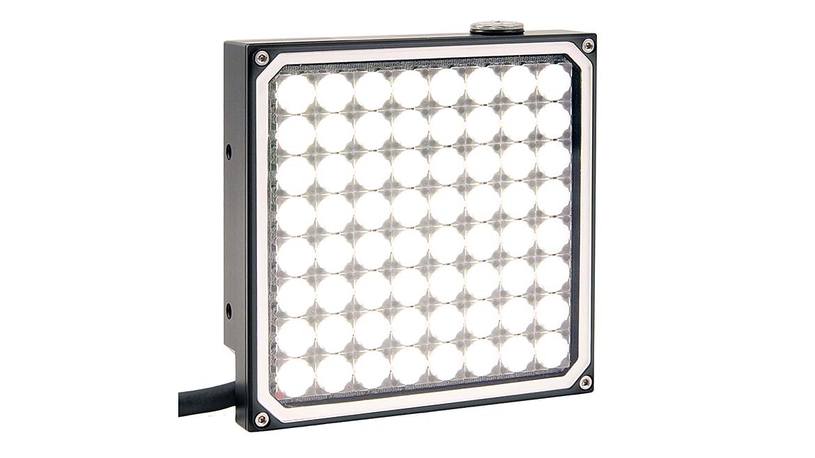

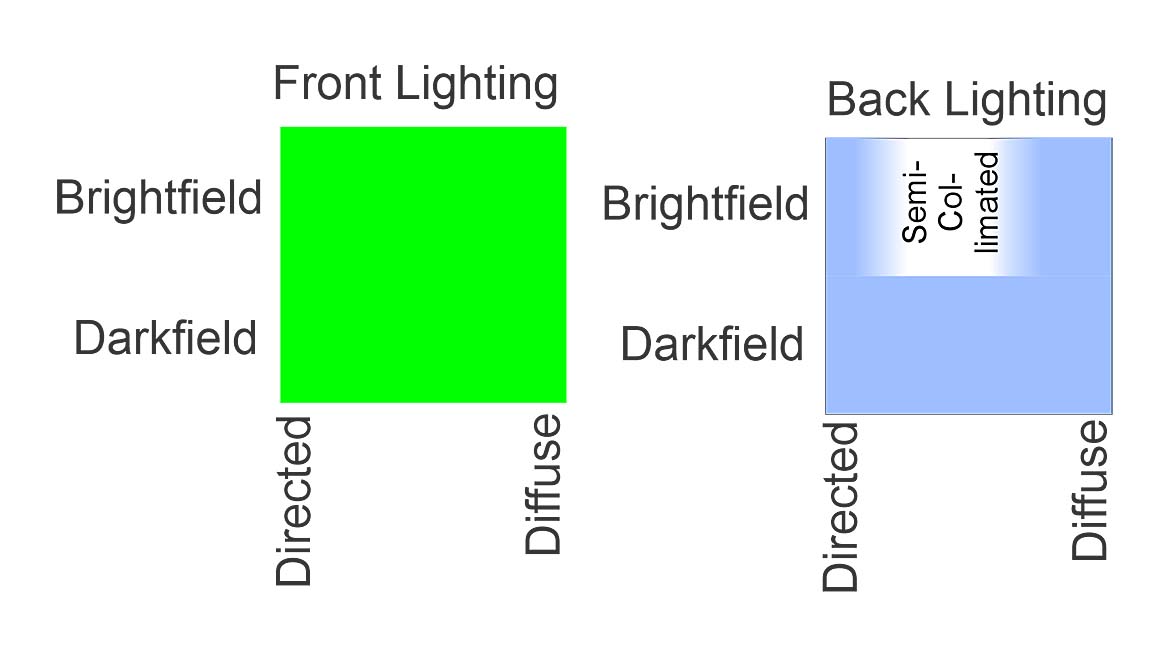

Semi-Collimated Back Light

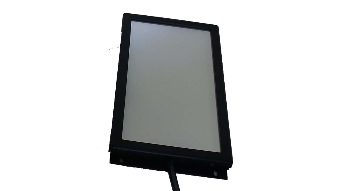

The semi-collimated back light (see Figure 25), also called by some people a collimated back light, is similar in appearance to the diffuse back light. In fact, it is a diffuse back light with collimating films to restrict the light output angle. Where the diffuse back light emits light over an almost 180° angle, the semi-collimated back light emits light through an angle range of around 30°.
This appears to be a type of specialty lighting, possibly a flat collimated backlight or an LED light boxFigure 25 -- Semi-Collimated Back Light - Image Source: Perry West
The semi-collimated back light maps onto the lighting cube similarly to the diffuse back light, except it is more directed, as shown in Figure 26.
The image displays a diagram illustrating different types of lighting techniquesFigure 26 -- Semi-Collimated Back Light Mapped onto the Lighting Cube - Image Source: Perry West

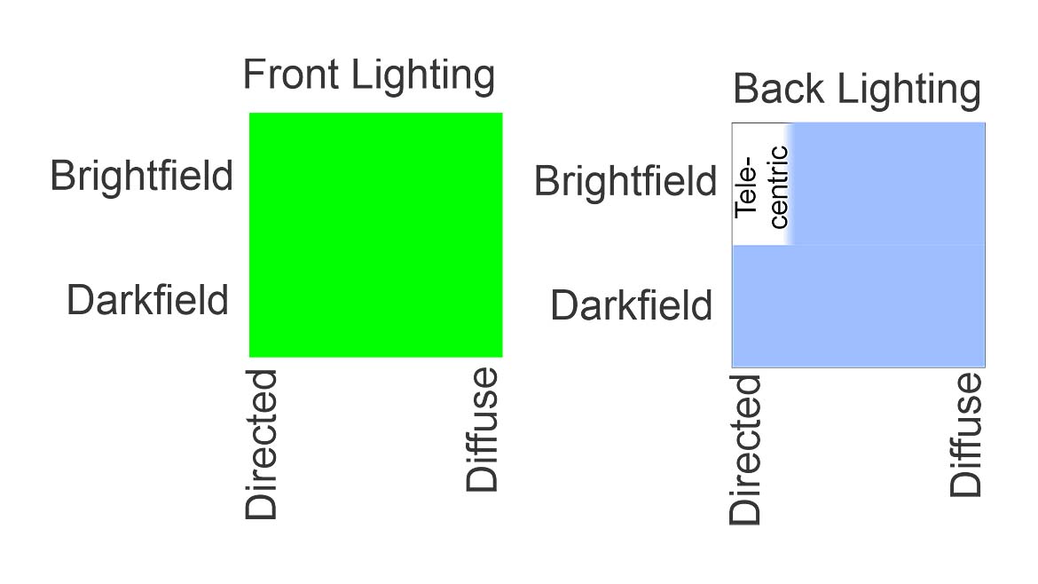

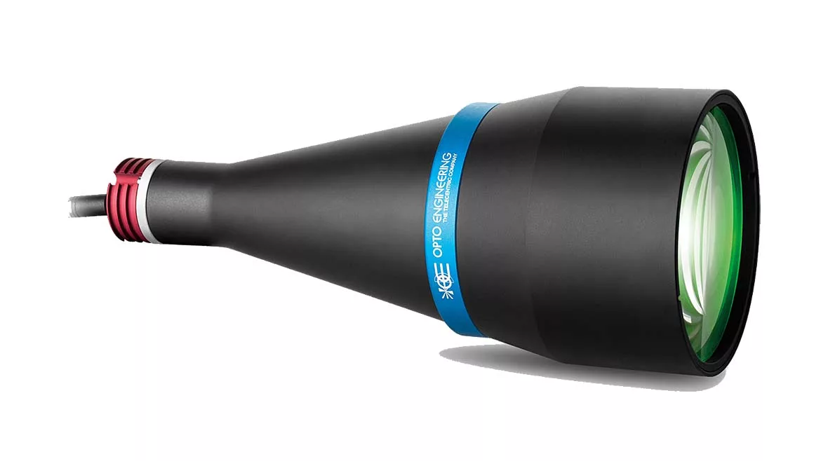

Telecentric Light
The telecentric light is a light projector using a telecentric lens. (See Figure 27.) This results in highly collimated light where each point on the scene is illuminated perpendicularly with an extremely narrow range of light angles.
This is an Opto Engineering telecentric lens, used in industrial machine vision for precise measurement applicationsFigure 27 -- Telecentric Light - Image Source: Perry West
Because only a very small fraction of the light output reaches any point on the scene, telecentric lights are used primarily for back lighting. Due to their collimation, telecentric lights must be as large as or larger than the size of the scene and be used with a telecentric lens.
The image displays two charts contrasting different types of lighting techniquesFigure 28 -- Telecentric Light Mapped onto the Lighting Cube - Image Source: Perry West
Figure 28 shows how the telecentric light maps onto the lighting cube as very direct bright field back lighting.

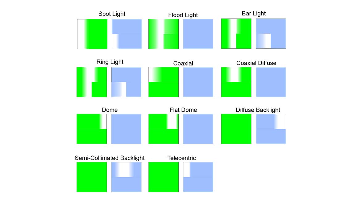

This second article in the series on lighting introduced the lighting cube and showed how the light sources commonly used in machine vision illumination fit into the lighting cube. Figure 29 shows all the light sources covered and how they map onto the lighting cube. Overlaying all the mappings shows the range of lighting covers all of the lighting cube except for the lower left corner for both front lighting and back lighting. As previously stated, this is due to the impossibility of having very diffuse dark field lighting.
QM0226-OO-Vision-West-2-FiguraThe image displays various types of machine vision lighting techniques, illustrating their general illumination patternse-29.jpgFigure 29 -- All Light Sources Mapped onto the Lighting Cube - Image Source: Perry West
The image displays various types of machine vision lighting and their characteristics, categorized by their direction and diffusionFigure 30 -- Range of Light Sources for Front and Back Lighting Ranging from Direct to Diffuse - Image Source: Perry West
