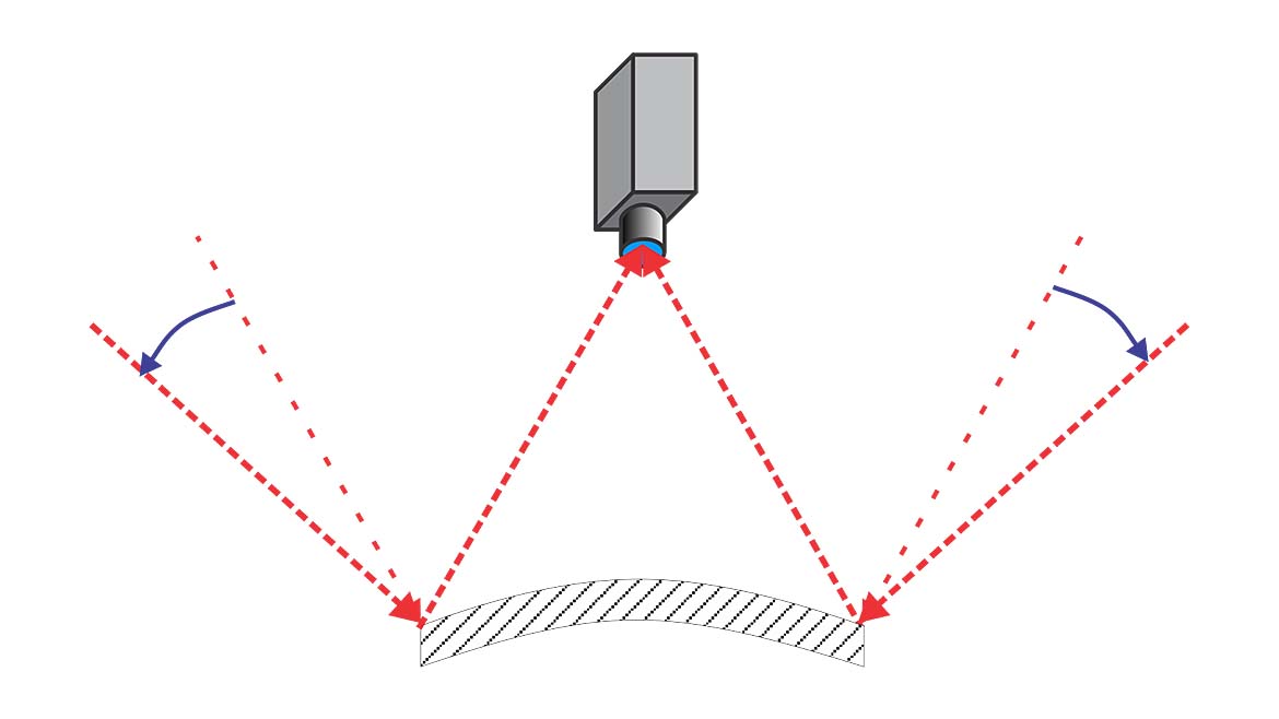

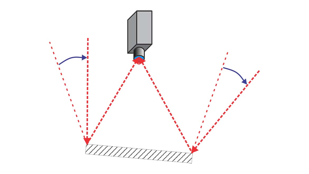

Figure 4 - Illumination "W" for a Sloped or Tilted Surface

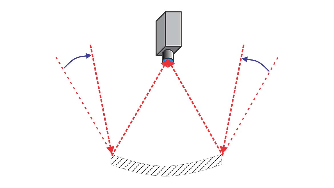

Any change in the physical properties, such as slope, tilt, or curvature, alters the “W” as shown in Figures 4 through 6.
Evixmatic 20
Figure 5 - Illumination "W" for a Convex Surface

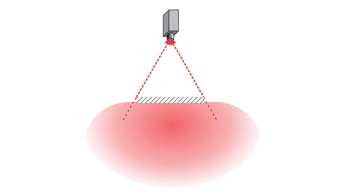

Any change in the reflection properties from specular, blurs the outer arms of the “W”. Diffuse reflectance blurs the arms over a range of 180°. The illumination “W” virtually disappears as shown in Figure 7. Light energy striking any point on the surface from any direction is scattered, with some of the light going into the camera’s lens.
While Figure 7 seems to indicate the light is coming from the camera, the property of light called isotropy where the behavior of light is the same regardless of its direction (of incidence) applies, and Figure 7 is a reasonable representation of what happens to the illumination “W”. Semi-diffuse surfaces blur the arms of the “W” over a smaller range of angles as shown in Figure 8.

Figure 6 - Illumination "W" for a Concave Surface

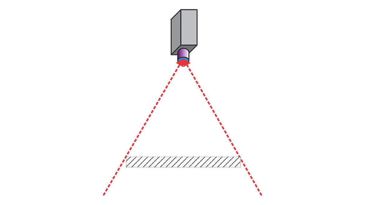

For flat transparent materials, the illumination “V” is shown in Figure 2. What Figure 2 doesn’t represent is the effects of refraction, the bending of light, when passing through the material. For surfaces that are flat, perpendicular to the camera’s view, and not excessively thick, the illumination “V” is close enough to accurate for lighting design purposes.

When the surface is curved, domed, or very thick, the illumination “V” is modified, possibly significantly, and the changes must be considered. These effects can be evaluated with ray tracing or with experimentation to predict how the illumination “V” is modified.

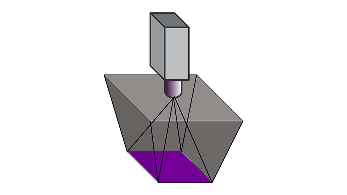

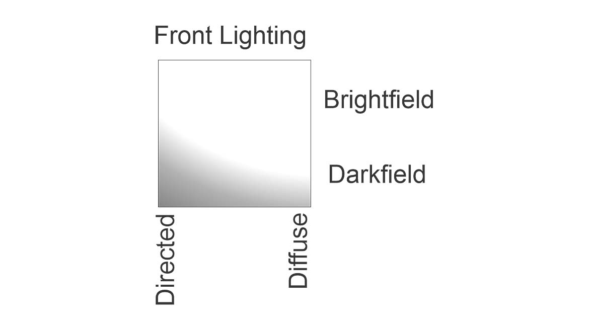

Each optical property, specular, diffuse, and semi-diffuse for reflection and opaque, transparent, and translucent for transmission, is mapped with a physical property onto the lighting cube to show what lighting direction characteristics will produce a bright area and which will produce a dark area. This results in a very large number of mappings.
Like the mapping of light sources onto the lighting cube in the second article in this series, the mapping of scene characteristics onto the lighting cube is also subjective. Still, as will be shown in the fourth article, combining the mappings of scene characteristics with the mappings of light sources gives a good indication of which light source will work for most machine vision applications.

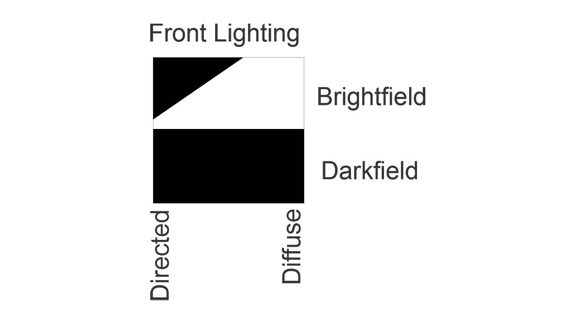

Figure 10 shows the mapping of the flat specular surface onto the lighting cube. Note for specular reflection, this mapping only applies to front lighting.
Evixmatic 20
Figure 10 - Flat Specular Surface Mapped onto the Lighting Cube

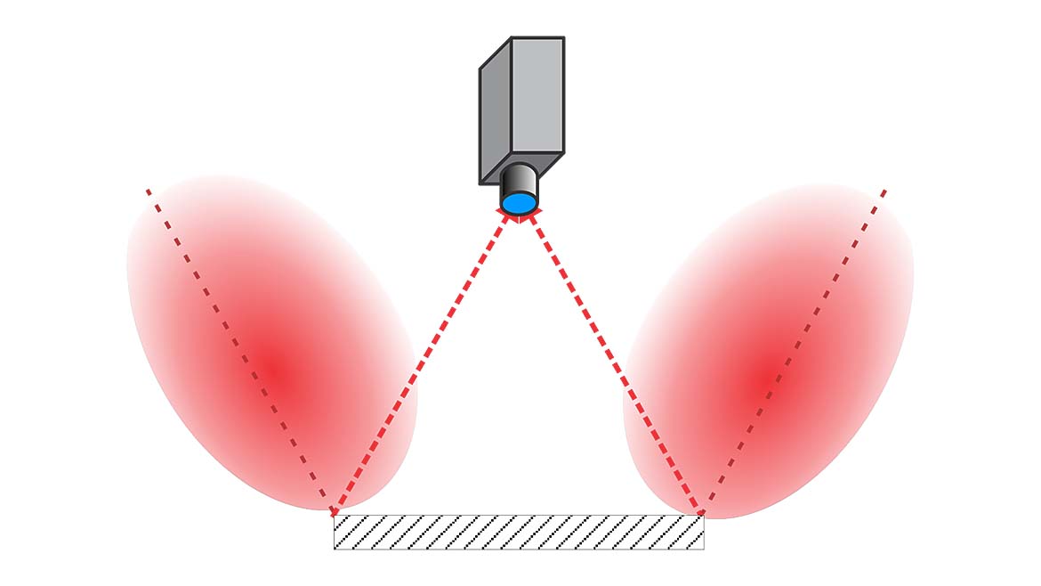

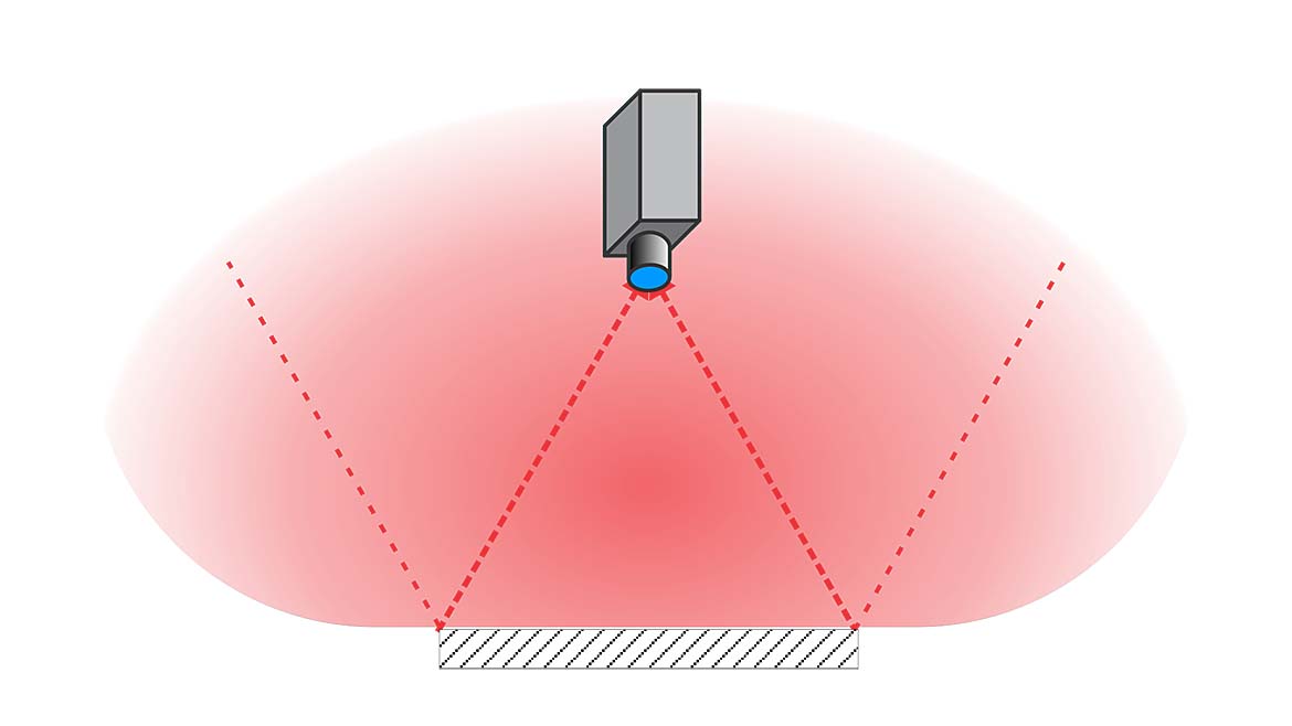

To make a specular surface bright, the whole interior of the illumination “W” needs to have light energy falling on the surface. Only a diffuse light source will make the entire surface bright. Partial bright field lighting, where the light is more directed and fills only part of the “W”, only makes a portion of the surface bright and is not usually useful for a specular surface. This is indicated by the dark triangle in the area of directed light.

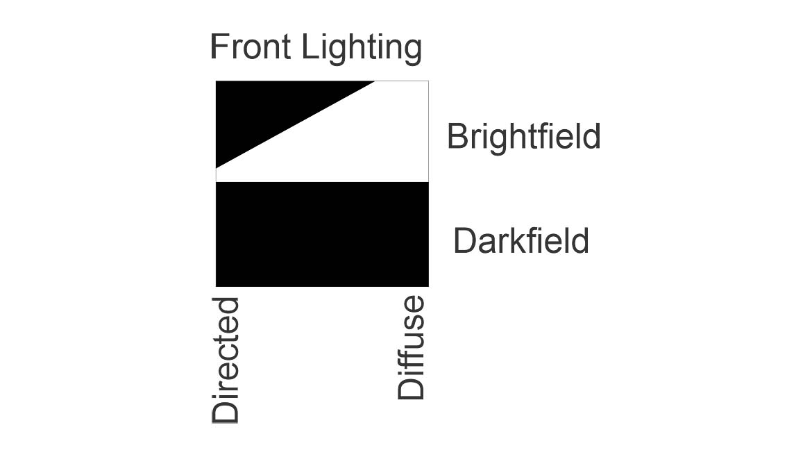

A convex specular surface is similar to the flat specular surface. Since the outer legs of the illumination “W” are broader, the light source needs to be even more diffuse than for a specular surface. This is shown in Figure 11. For a concave specular surface, the “W” becomes narrower, and the light source, while still needing to be diffuse, can be less diffuse. This is shown in Figure 12.

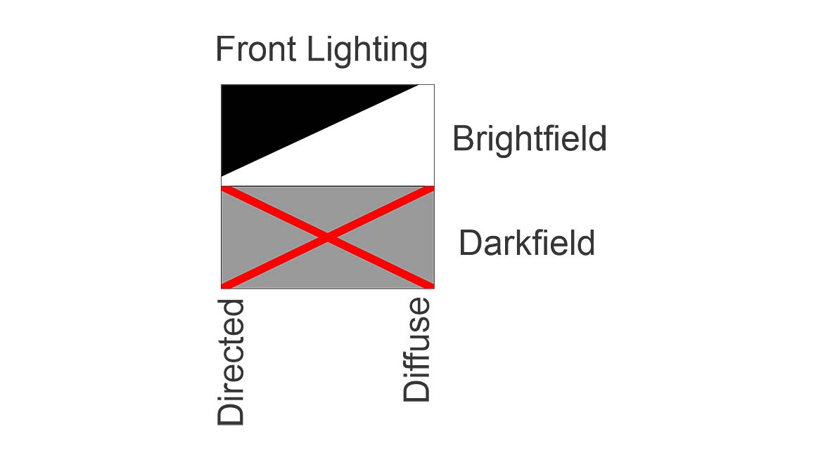

Round objects present very interesting lighting challenges for machine vision. For the purpose of mapping onto the lighting cube, a round object is any surface with sufficient curvature that the outer arms of the illumination “W” reach or exceed the horizontal.
One characteristic important to lighting design is the absence of a region for dark field illumination for front lighting. This is shown in Figure 15, where the dark field portion is X’d out.

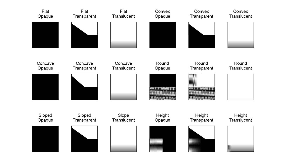

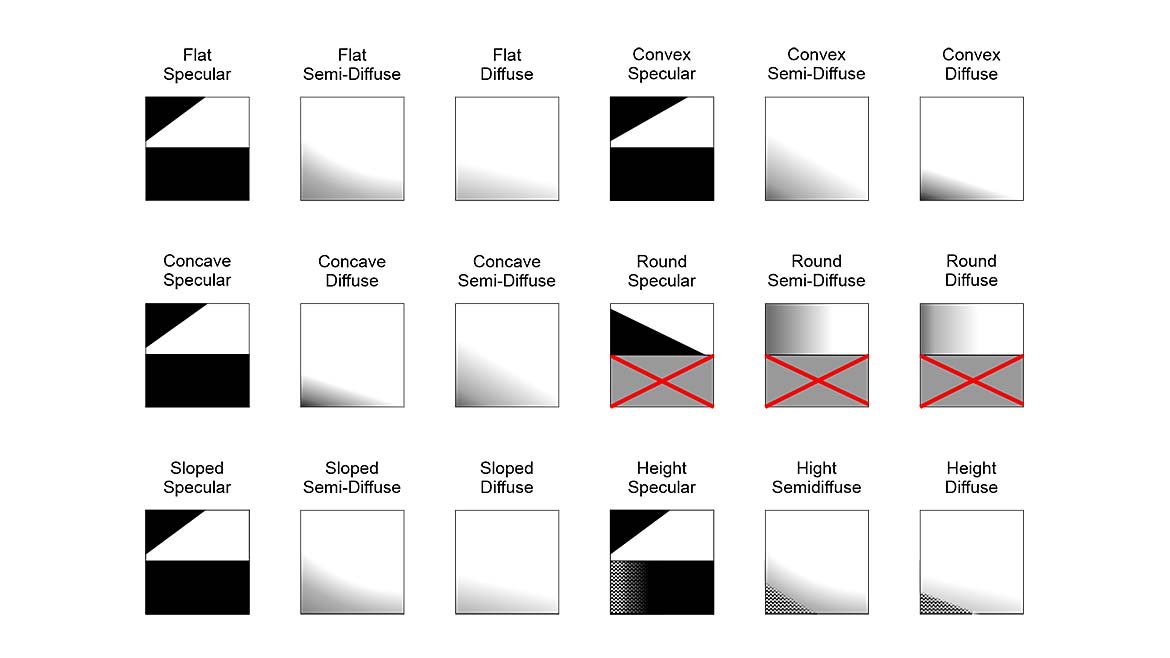

Figure 17 - Scene Analysis Mappings onto Front Lighting Portion of the Lighting Cube
There are quite a number of mappings of scene analysis conditions onto the lighting cube. These are shown in Figure 17 for front lighting and in Figure 18 for back lighting.
Evixmatic 20

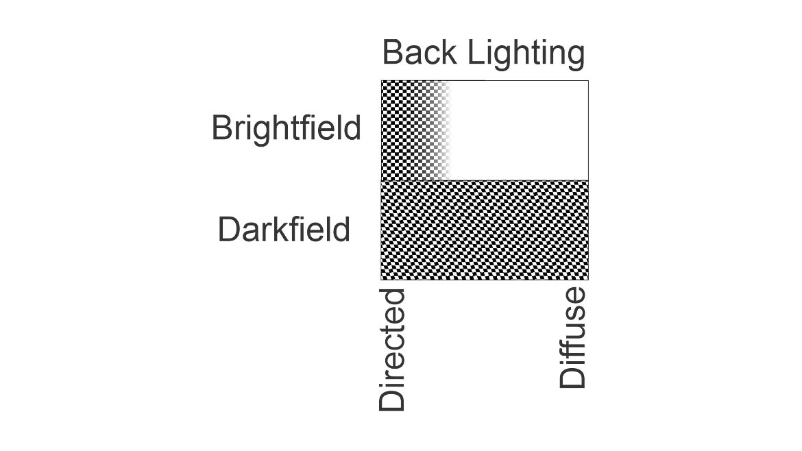

Figure 18 - Scene Analysis Mappings onto Back Lighting Portion of the Lighting Cube
You can download all the mappings at: https://drive.google.com/drive/folders/11WdHzAfFHBUO9tI7Q6zB9op8xRcPrFSb?usp=drive_link.
