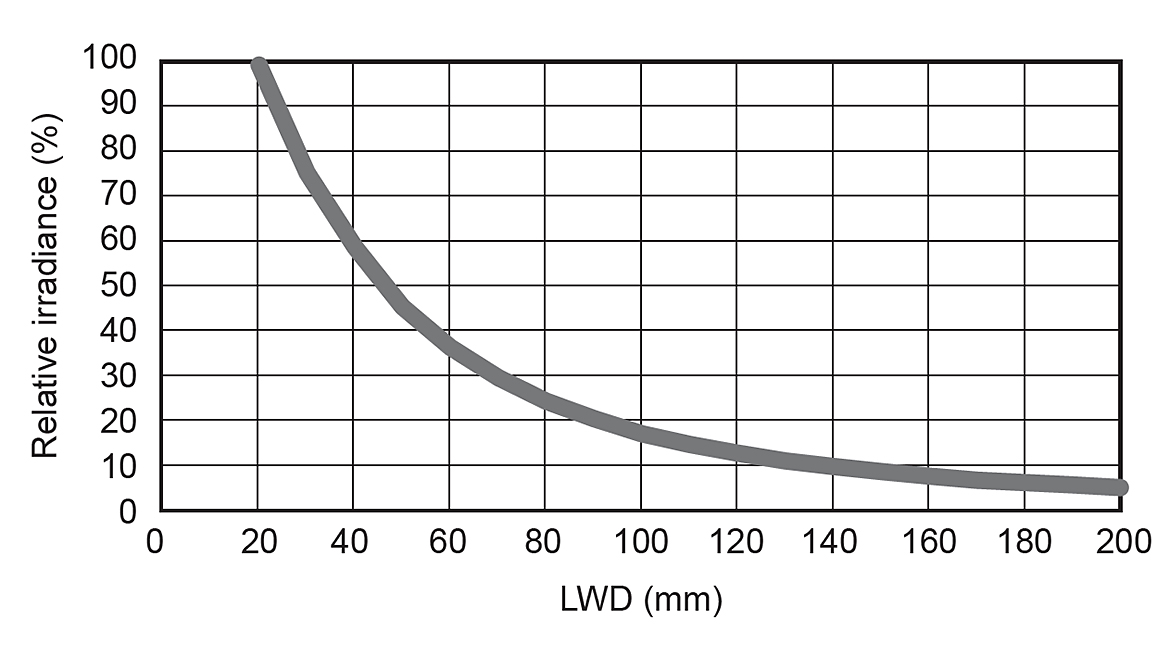

Getting enough light for a high-speed application is not as simple as confirming the lux at a given working distance. Because whether a light is bright enough is more about how much light is reflecting off a sample, not how much light hits it. Are we capturing direct or scattered light? Is the sample going to absorb a lot of light?
Even if the light has a high intensity, the inspection target will still be undetectable if the sample does not reflect enough light to the camera. This challenge becomes even harder in high-speed applications, where lights must be significantly brighter to compensate for short exposure and avoid blur.
Relative irradiance graph
There is a common misconception that if a light has enough lux at the distance that it will be installed from the sample, the image will be bright enough. In reality, the way light interacts with a given workpiece means there can be a lot less light actually reaching the camera, and the inspection target may be too difficult to detect as a result. Image Source: CCS America

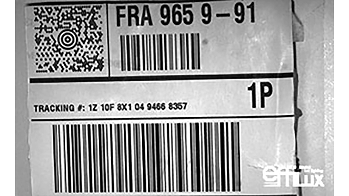

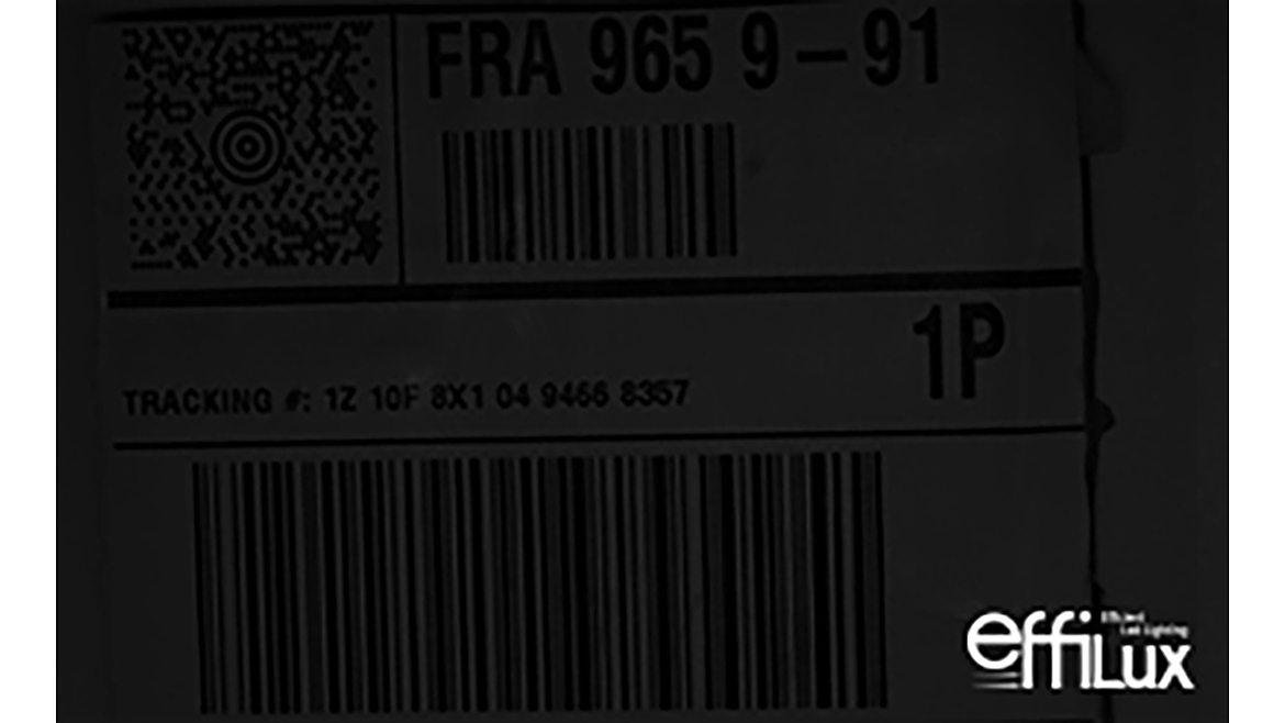

In flood lighting applications, the contrast is there even without lighting, such as a dark barcode on a light background. There is no specific direction or LWD required to see the target information, and the main purpose of lighting is to evenly illuminate the entire field of view.
NG-FLEX Autostrobe twenty-twenty
Image Source: Effilux
OK FLEX LG Megastrobe twenty-twenty barcode
Barcodes, such as those in logistics applications, already have high contrast. Dedicated strobe flood lighting ensures the image is bright and uniform for code reading, even at long working distances. Image Source: Effilux
A dedicated strobe flood bar light can provide uniform illumination, so ambient light or other factors do not affect the image day to day. The most common application of high-speed flood lighting is logistics, where thousands of packages need to be scanned every day. Flood lights also provide the intensity needed for high-speed applications that require installing lights at longer working distances.

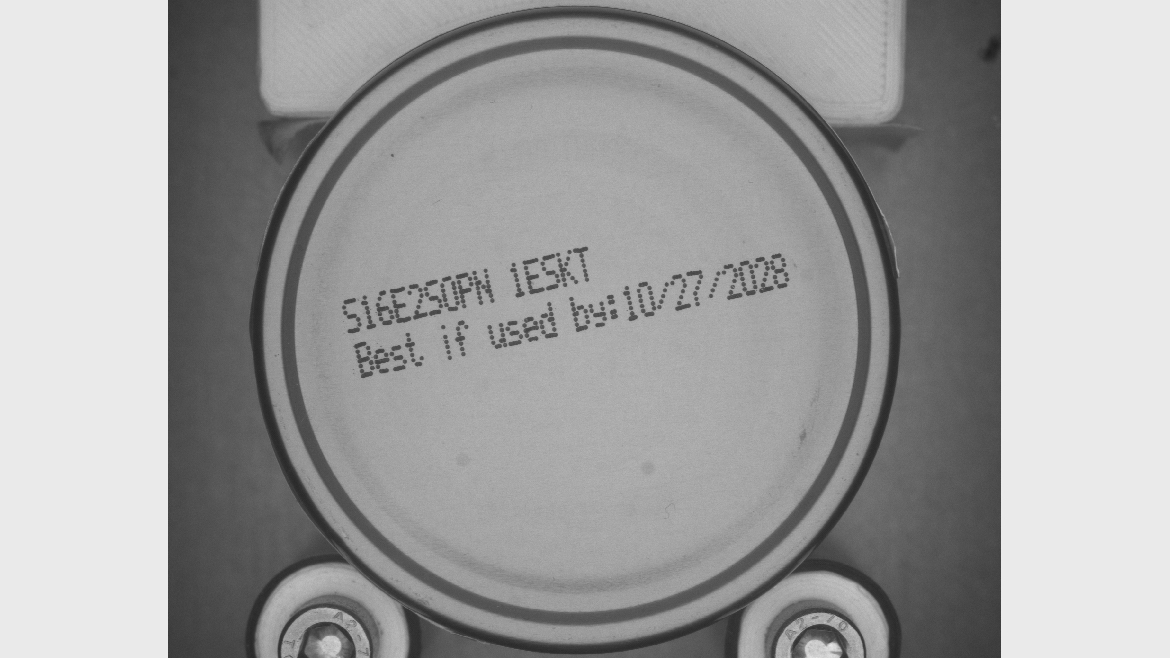

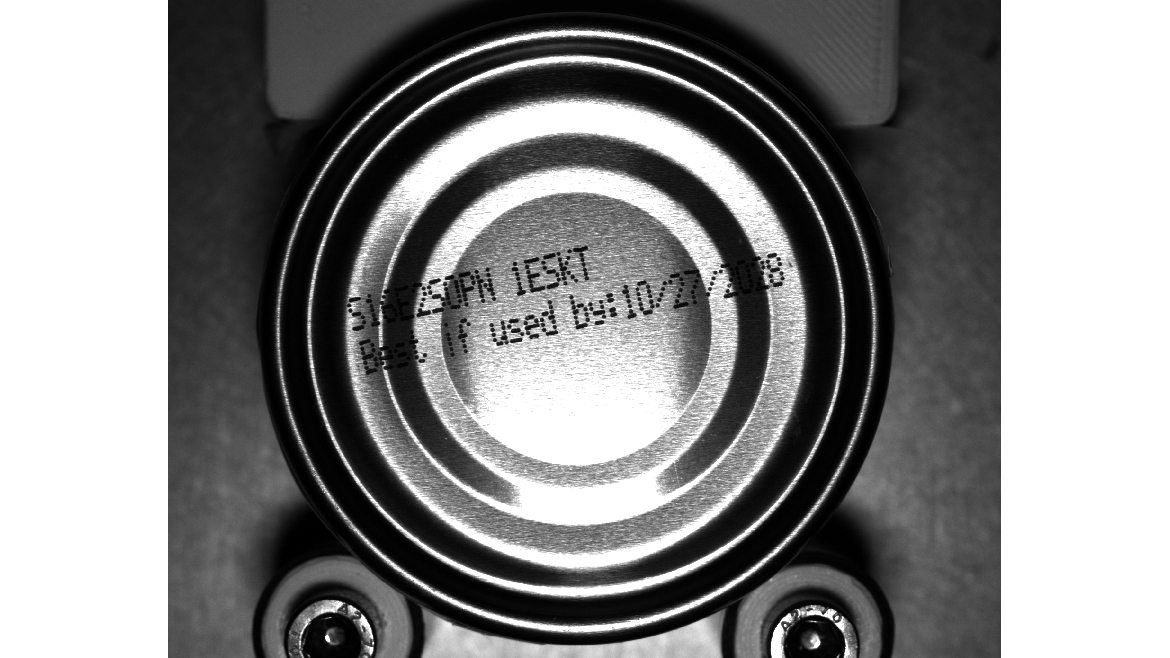

Inspections that use precision lighting have a specific detail that needs to be seen that has little to no contrast on its own. Engineers must factor in what wavelength, direction, angle, size, and optical accessories will do the most to enhance uniformity for the highest possible contrast, or else the system will not be accurate enough to be reliably deployed.
Top view of a food can label that's difficult to see due to light.
Food can label, clear image with no blur or bright light.
Sometimes, flooding the FOV with a lot of light makes it harder to see the target information. A lighting solution with a specific lighting geometry, working distance, etc. will clearly highlight the defect and emit enough light, so the image is bright with no blur. Image Source: CCS America
Since higher intensity lighting may create more harsh specular reflections, especially on curved or shiny parts, precision lighting solutions become even more crucial in high-speed applications. High-speed precision lighting must provide different types of lighting geometries in addition to strobing capabilities, so that there is as little noise as possible interfering when capturing the defect.
