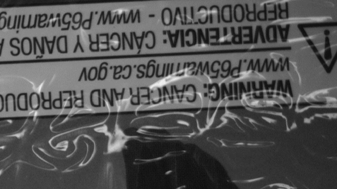

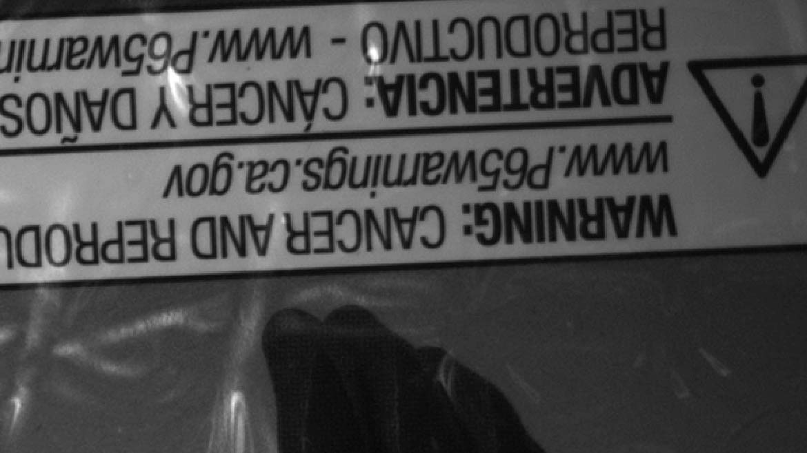

Overpowering glare works by reducing the camera's exposure time so that ambient light is too weak to register, then using a high-intensity or overdriven machine vision light to ensure only the intended illumination is captured. This effectively drowns out ambient interference by making your controlled light the dominant source in the image.
Start by shortening the camera’s exposure time until ambient light alone no longer produces a visible image. Then, increase the machine vision lighting intensity so the target is properly illuminated within that shortened exposure window.
If standard intensity is insufficient, overdriving the light is the next step. Overdriving involves delivering short bursts of high-intensity light without damaging the LED. This requires a controller capable of regulating pulse width and duty cycle to protect the hardware while boosting brightness, or a light specially designed to overdrive at an extremely high brightness.
(Image: “Glare_Overpower” images)
Caption: The image with a faster shutter speed (right) has significantly less glare compared to one captured with a slower shutter (left). A faster shutter speed means light has less time to reach the camera, and that includes the light causing unwanted glare.

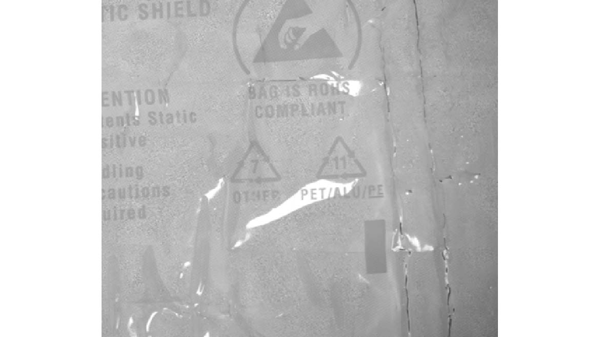

Bandpass filters are especially useful when using monochromatic lighting (red, blue, green). When applied to the lens, these filters allow only the wavelength of your machine vision light to pass through while blocking out most of the unwanted ambient spectrum. While not as effective as shrouding or overdriving, bandpass filters can reduce the impact of ambient glare on an image.
bandpass
bandpass
By combining a red monochrome light with a red bandpass filter, non-red wavelengths are blocked from entering the camera sensor. While it does not completely eliminate glare, it can reduce its effects by as much as 80%.

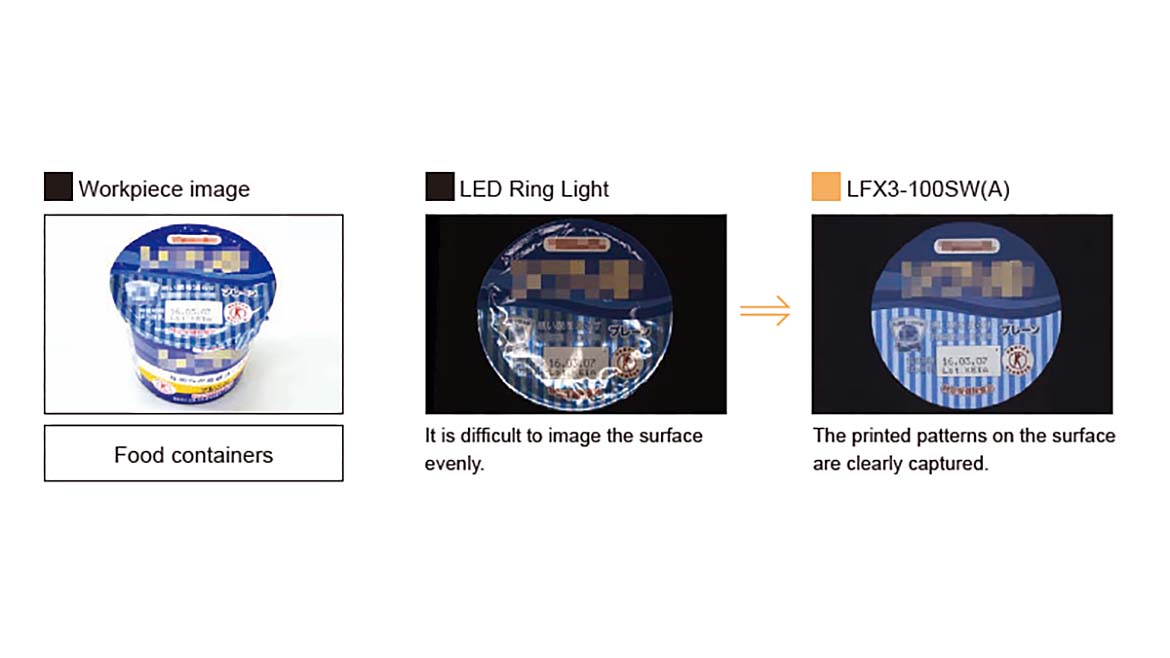

Switching to a more effective lighting form factor can do a lot to improve glare. For example, coaxial lights use a beam splitter to deliver light from directly above the object, making them excellent for flat, specular surfaces like glass, PCBs, or machined parts. Then there are form factors for emitting diffused light. Dome lights are the primary diffused light form factor, and they can be especially effective for curved or shiny surfaces that reflect light unpredictably. By lighting the target from all directions, they minimize the chance of any one reflection hitting the camera.
It is also possible to get more diffuse light not by switching to a different form factor, but by adding a diffuser accessory to the existing light to increase the scattering of its light rays. In situations where there is not enough space to accommodate another form factor or the glare is not a major problem using the existing lighting, a diffuser can be the best option. Keep in mind that while diffusion increases uniformity, it does so at the cost of brightness. Choosing the right diffuser (mild, moderate, or heavy) can balance your application’s intensity and uniformity requirements to remove glare without losing the brightness needed to detect target features.
food container
Diffuse lights are frequently used to remove glare when inspecting shiny workpieces. In this example, a flat dome light provides diffuse illumination to remove glare from an image of a reflective film of a food lid.

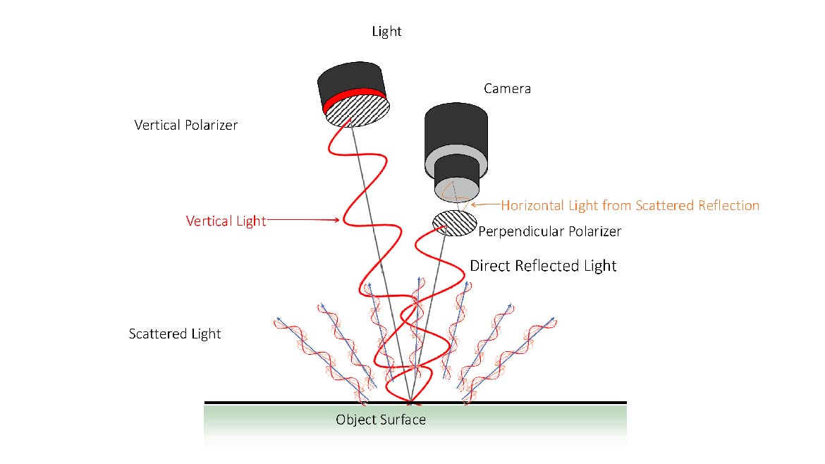

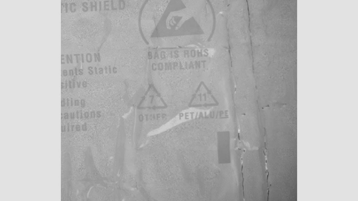

Polarization is another effective method to control reflections. When polarizers are placed on both the light and the camera lens at perpendicular orientations, they block specular reflections while allowing diffuse reflections to pass through.
polarizer
Polarizers aligned perpendicularly block unwanted glare by only allowing diffused light scattered by the sample to reach the sensor.
Image Source: CCS America
Here’s how it works: polarized light reflects specularly off a surface while retaining its polarization. By aligning the camera polarizer perpendicular to that of the light, you can block this reflected light, reducing glare. Meanwhile, diffuse reflections, which lose polarization, are still visible.
This technique is highly effective for glossy or mirrored surfaces but reduces overall light throughput. It’s best used in systems where light intensity is ample or can be increased to compensate.
no polarizer
with polarizer
When the polarizer on the light and on the camera are misaligned, you will still see glare in an image (left). By rotating the polarizers until they are perpendicular, the glare will disappear from the image (right).Image Source: CCS America
