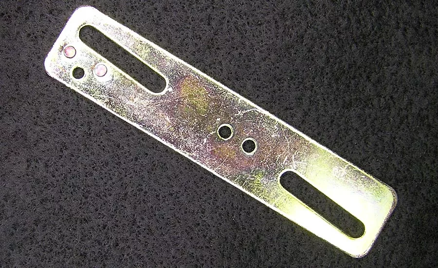

metal bracket on black background
Figure 2 – Metal Bracket on Black Background.
Example
Figure 2 shows a metal bracket on a black background. The bracket can be characterized as flat, rough (due to what appear to be resolvable surface scratches) and isotropic (although individual scratches appear different depending on the light direction the randomness of scratches gives the part a texture that is generally light direction insensitive), semi-diffuse (it is not mirror-like, but can still have hot spots from the illumination) and isotropic (reflectivity does not depend on the light direction) with a white color, opaque, and no emission. The background can be characterized as flat, rough (due to its resolvable texture) and isotropic (since it does not have a preferred direction), diffuse and isotropic with a dark (black) color, opaque, and no emission.
scene characteristics
Figure 3 – Scene Characteristics.
Figure 3 shows how the form might be filled out for this scene. Obviously, similar characteristics cannot be used to create high contrast. The differences in this example are a) the reflection that is diffuse for the background and semi-diffuse for the bracket, and b) the color difference between the bracket and the background.
Since it is not desirable to resolve the texture, the selected lighting method will need to suppress texture rather than make it distinct.
Semi-diffuse surfaces are prone to hot spots as they reflect the light. Hot spots are almost always undesirable.
Since both the object and the background are opaque, backlighting is ruled out. That leaves front lighting as the preferred technique.
For front lighting, the illumination “W” (see Figure 4) differentiates between bright field and dark field lighting. Light within the “W” is bright field, and light outside the “W” is dark field.
Figure 4 – Illumination “W”
Diffuse surfaces and, to a lesser extent, semi-diffuse surfaces will reflect some dark-field light into the camera. It would be possible to use dark field front lighting except that this lighting would highlight the texture of both the part and the background.
Bright field front lighting from a directed source, such as a ring light or coaxial illumination will produce a hot spot on the semi-diffuse part. So, a diffuse light source such as a dome or a flat dome will work. Since flat dome lights (see Figure 5) are less expensive and give a greater clearance to the part, the flat dome would be the choice for this application.
