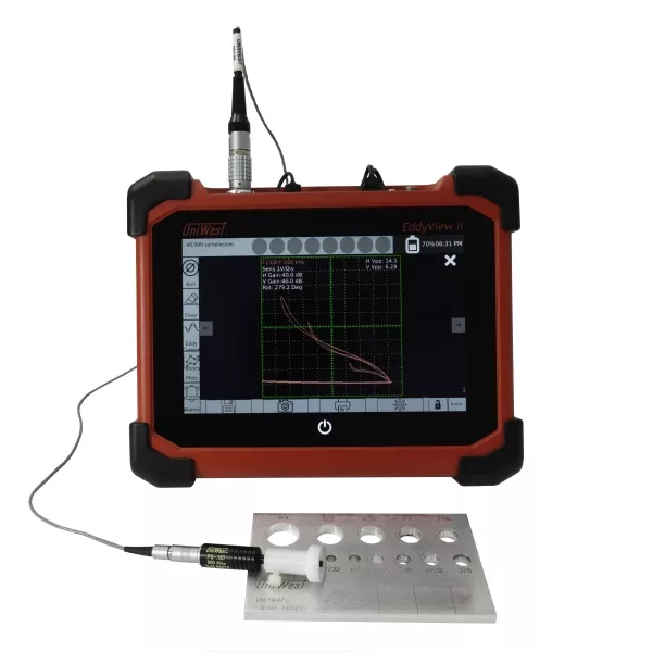

UniWest announced the introduction of the new EddyView® II portable eddy current flaw detector at the ASNT Annual 2022 Conference on October 31, 2022.
The innovative EddyView II features a large 8-inch touch screen display with gesture adjustments for key parameters such as gain and rotation, ability to drive conventional probes or array probes, an independent channel that monitors probe to part coupling (liftoff), and UniWest’s industry-leading signal performance with extremely low signal-to-noise.
The EddyView II also includes multi-frequency probe drive and signal mixing, digital conductivity & non-conductive coating thickness, and compatibility with UniWest’s ECS-1S & JF-15 rotating bolt hole scanners. In addition, the EddyView II can be connected to the internet for remote diagnostics and calibration, as well as export raw eddy current data for post-processing flexibility.
While using the EddyView II in demanding and often dirty NDT environments, its rugged housing is designed to meet the standards of Ingress Protection (IP) rating IP-65.
Designed for use by NDT professionals, the EddyView II includes all the advanced features and functionality to allow both standard eddy current measurements and complex inspections, including use of eddy current array (ECA) probes up to 32 elements as well as large-scale automated and robotic production applications.  System features include multi-frequency with mixing, split-screen for both impedance plane and O-scope/sweep modes, digital conductivity measurement, non-conductive liftoff digital measurement, rotating scanner support for high-speed bolt hole scanning, Ethernet connectivity, alarm outputs, and USB flash drive support.  Ideal for field, laboratory, or production settings, the EddyView II’s fast data acquisition rate facilitates smooth system integration.
