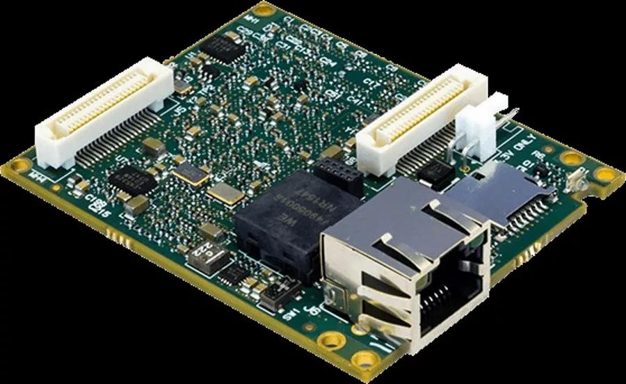

Pleora Technologies introduced a new embedded interface that seamlessly transmits low latency GigE Vision video and data at 10 Gbps over flexible Ethernet cabling. Lead customers are now designing the iPORT NTx-Deca embedded interface into X-ray flat panel detectors (FPDs) for medical, dental, and industrial applications, contact image sensors, and high-performance machine vision cameras.
Compared with competing approaches that consume design time and dollars and divert development teams from critical system performance features, the iPORT NTx-Deca provides an off-the-shelf GigE Vision standard compliant solution that ensures interoperability in multi-vendor systems. Connect your sensor to the iPORT NTx-Deca, and the off-the-shelf solution seamlessly handles 10 Gbps video and data transport over flexible Copper Cat 6A Ethernet cabling for distances up to 100 meters. GigE Vision 2.0 compliance streamlines interoperability in multi-vendor imaging systems and applications.
The iPORT NTx-Deca integrates unique Image Management Database features to enhance system reliability. For high-reliability applications, such as medical and dental imaging, end-users can store video frames with associated metadata for patient identification, video replay, and traceability. In the event of a power or network failure, image management allows a user to retrieve data to ensure continuous and reliable inspection. The embedded interface supports IEEE 1588 Precision Time Protocol (PTP) to synchronize image capture and imaging system elements, with programmable logic controller (PLC) integration to seamlessly connect to and control critical manufacturing or inspection system components.
