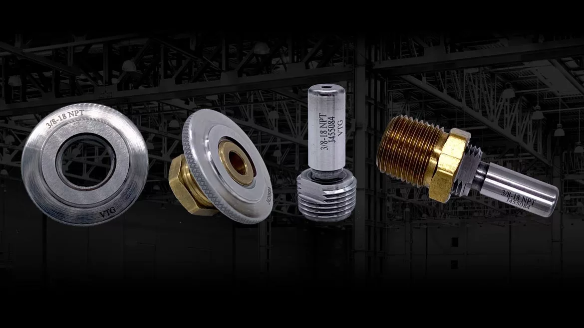

Taper Pipe Threads are one of the more challenging threads to produce and measure. The ASME B1.20.1-2013 Pipe Threads, General Purpose (Inch) is the current standard that covers both the part thread specifications and the gages for NPT, NPSC, NPTR, NPSM and NPSL threads. We will be focusing on the National (American) Standard Pipe Taper (NPT) threads. Generally, NPT taper pipe threads are a 60° thread form that is tapered at 0.75 in / ft. (1°47’ half angle). The taper causes the rules for Go and No-Go gage inspection to change as compared to straight threads. To understand the gages, we must first understand how the part threads work and their purpose.
NPT part threads have a tapered internal thread that assembles with a tapered external thread. Per the ASME standard, “The mating threads should always contact on the thread flanks. The design tolerances are such that mating crests and roots may clear, contact, or interfere. This joint may not necessarily seal, unless a sealant is used. ” (See the ASME B1.20.1-2013 for the illustrations of the root and crest clearances.) If you require a pressure tight seal, a sealant must be used on the wrench-tight length (L2 external and L3 internal).
The Illustration in Fig. 1 shows the basic thread form of the hand tight (L1) part assembly of internal and external threads. This includes some of the definitions as stated in the ASME standard.
QM 0323 Quality101 NPT Figure 1
Figure 1 | Image Source: Vermont Gage
The Fixed Limit gages for the NPT thread form are L1 thread plug and ring gages. The L1 thread plug and ring gages inspect the L1 length of engagement of the internal and external NPT part thread. The inspection is done as a reference to a calibrated pitch diameter at a specific length on the tapered thread. This pitch diameter at the L1 length is shown above as E1 in Fig. 1.
NPT L1 thread plug gages have a Basic notch ground to the E1 pitch diameter at the L1 length. The internal part thread is considered in tolerance if the notch on the gage is within +/- 1 turn from the face (Flush) of the part thread. (See Fig. 2)

NPT L1 thread ring gages do not have a notch. The thickness of the ring equals the L1 Basic length. The large end of the ring equals the E1 pitch diameter. The external part thread is considered in tolerance if the small end face of the NPT L1 ring gage is within +/-1 turn of the small end of the part thread. (See Fig. 3)
