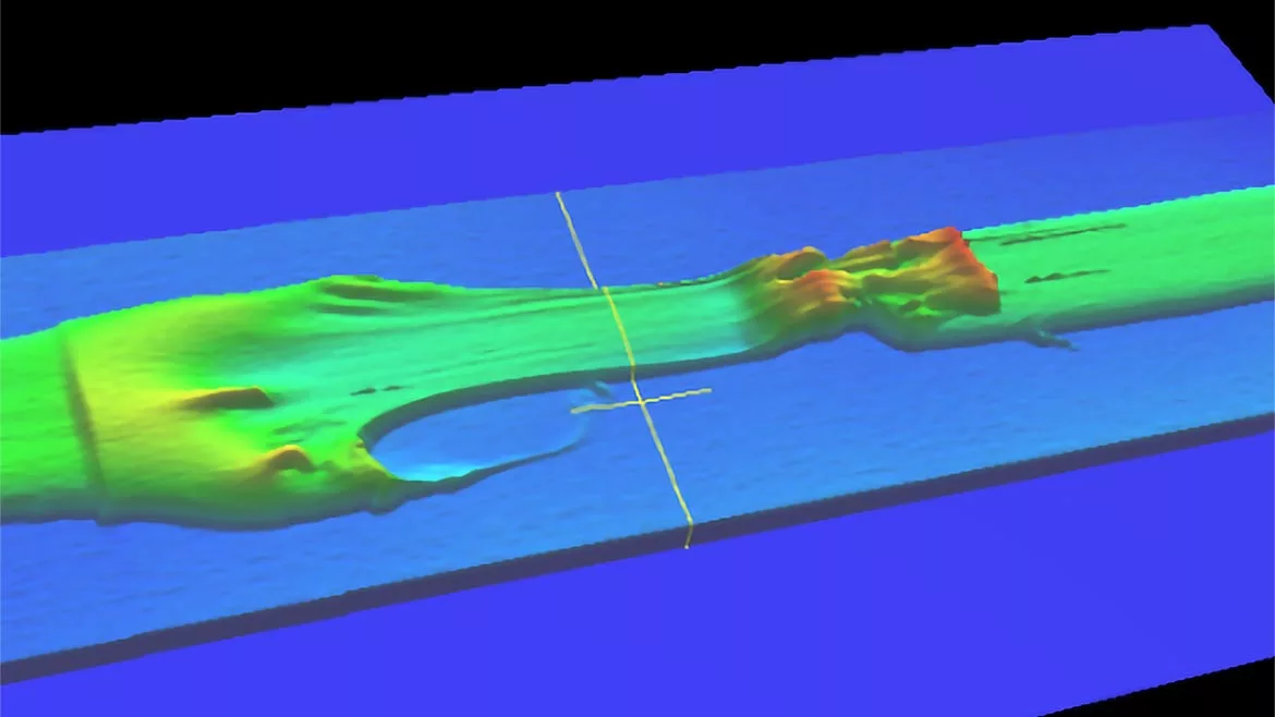

QM 0723 Test & Inspection A Low Volume Failure
3D vision is able to detect this low volume failure, although 2D vision would have missed it because bead width meets specification.  Image Source: Coherix
All Vision Is Not Created Equal
Inspection systems are needed to control the dispensing process for battery manufacturing. Vision provides data for part traceability, which is of the highest importance for OEMs concerned with overall quality, warranty issues and potential recalls.
There are a variety of vision-system options: some are 2D, some are 3D, some are post-inspection and some are in-line.
The major downside to 2D vision is that it is not possible to measure volume, which is a crucial measurement in the dispensing process. Many 2D vision systems are post-inspection, which means they do not start until after the material has been applied. Floor space is precious in any manufacturing environment and 2D post-inspection vision systems require additional floor space for lighting rigs, cameras, fixtures and additional automation equipment. Also, 2D vision is unable to decipher the difference between a part and the adhesive bead when the color of the part and adhesive material are the same (black on black or gray on gray) since camera cannot pick up the contrast between the two.
There are many advantages to using a robust inline 3D inspection system. When inspection is completed in-line there is no requirement for additional cycle time, floor space or additional fixturing. With 3D vision volume is measured, and material-color and part-color can be the same without affecting the system’s ability to provide accurate measurements.
QM 0723 Test & Inspection A 3D image Bead Plow Through
This 3D image shows that a dispensing nozzle has plowed through the top of a bead on this dispense cycle, failing to meet height and volume specifications. Image Source: Coherix
Another 3D vision advantage over 2D involves the fact that the dispensing nozzle can plow through the bead (as seen in image 1). Without a 3D image of the bead, it would be impossible to recognize if it failed to meet specification because the nozzle has plowed right through the bead and the (center) height and volume specifications have not been met. Last but definitely not least, the biggest in-line 3D vision benefit is its ability to provide real-time feedback to the robot and dispenser for process control.
