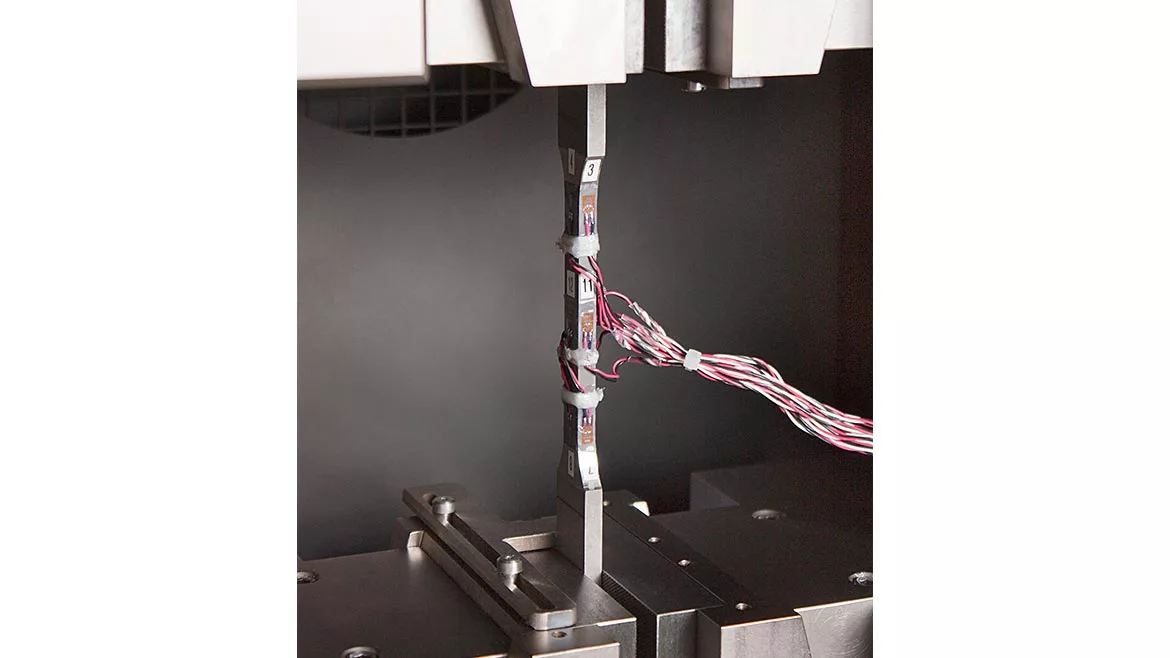

Verifying that your load string is set up to minimize bending is key to getting accurate and repeatable data. If the bending strain falls outside the allowable limit, the load string will need to be adjusted. This can be done manually by making tweaks to load string attachment points (e.g. loosening, tightening, adding shims, etc.). This is a method of trial and error until the data falls within the allowable limits. Manufacturers of tensile testers have identified this issue and provided a simple solution: an alignment kit can be added which allows fine adjustments to the angular and axial direction of the load string. Pairing this kit with a strain gaged specimen provides live read-outs of the bending strain.
