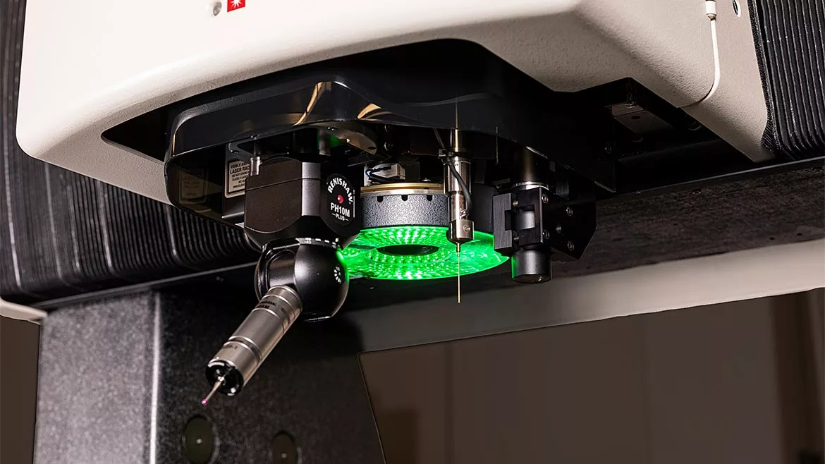

Multisensor Metrology Systems Quest 650

LED Ringlight surrounding the optical system of an OGP SmartScope ZIP Multisensor Measuring System.

Any modern multisensor system will come equipped with systems that provide light that is programmable for both direction and incidence angle, illuminating parts to achieve easy, accurate measurements.
The inner rings of an LED lighting system illuminate the part from above, almost “square on.” The outer rings provide oblique lighting, ideal for chamfered edges and blended radii. By selecting different rings, users control the angle of incidence of the illumination.
Each ring is also divided into sectors, allowing users to specify the direction of the light. Any combination of rings and sectors can be selected to create just the right illumination for any application.
Multisensor Metrology Systems SmartScope E45 LED Ringlighting
LED Ringlighting provides options to light features of parts from different angles and intensities.
