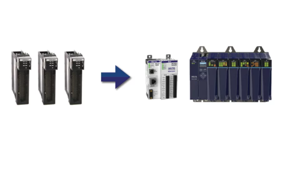

All three of the Rockwell Automation ControlLogix analog motion modules, 1756-HYD02, 1756-M02AS, and 1756-M02AE, have reached end-of-life and, as of December 2024, will be discontinued and no longer available for sale. Rockwell does not have a replacement option, which leaves a need for a motion solution that Delta Motion is uniquely positioned to fulfill. Rockwell Automation recommends that OEMs and system integrators consider RMC Motion Controllers as a replacement for these modules.
Delta’s RMC Motion Controllers can duplicate the function of the discontinued motion modules. They have the same I/O signals, communicate efficiently with Allen-Bradley PLCs via EtherNet/IP, and connect to all of the same field devices as the ControlLogix analog motion modules. Delta Motion’s sales and support team also has the expertise to support customers in converting from these modules to RMC motion controllers.
