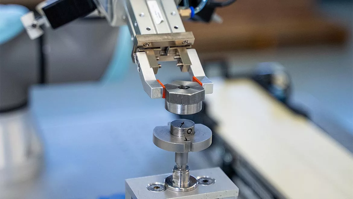

A collaborative robot presenting a part to a mechanical bore gage to measure the inside diameter of a machined part.
A collaborative robot presenting a part to a mechanical bore gage to measure the inside diameter of a machined part. All Images Source: New Scale Robotics

The Q-Span Gauging System uses a collaborative robot to present parts to a variety of gages, emulating the manual inspection process performed today with tools like calipers, micrometers, height gages, bore gages, and more.
