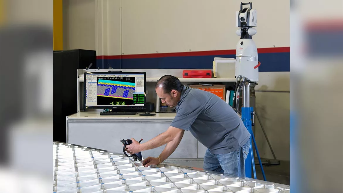

AMRO Quality Engineer Rodrigo Delgadillo inspecting flat machined grid panel wall thicknesses before forming using Verisurf inspection software and Leica laser tracker with wireless T-Probe.
AMRO Quality Engineer Rodrigo Delgadillo inspecting flat machined grid panel wall thicknesses before forming using Verisurf inspection software and Leica laser tracker with wireless T-Probe. Source: Verisurf Software
