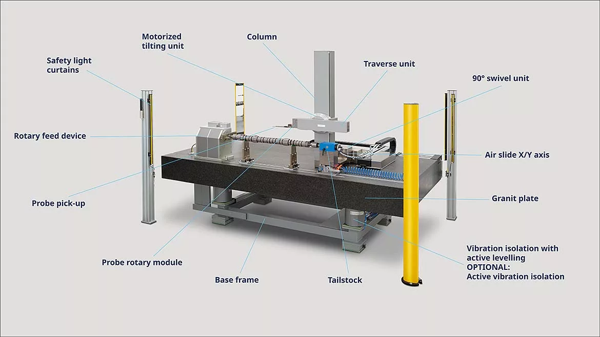

Automated measuring solutions for roughness, contour and twist usually pick up the shaft horizontally. After inserting the shaft, which is placed on a pair of prisms or clamped between two tips, and, if available, reading in the DMC code, a software starts the fully automatic measuring process. From then on, the measuring systems independently move to each measuring point, records each profile, and then evaluates it. The shaft can be rotated radially 360 degrees. The X and Y linear axes allow the measuring column to be moved freely on a granite plate. An automatic tilting unit swivels the feed up to plus or minus 45 degrees. A motorized turning unit can also turn the column by 90 degrees. An automized probe rotary module allows the probe – mounted on the front of the feed unit – to rotate up to 360 degrees. This allows roughness measuring areas to be approached automatically at all positions. The determined measurement features are called up on the screen and can be printed out. Features outside the tolerance are identified as “NOK.”
Roughness and contour measuring stations can be equipped with active level control and integrated vibration damping, which compensates for normal building vibrations. If this is not sufficient, individual vibration damping can be integrated into the measuring stations. However, this step should be preceded by a vibration analysis at the installation site.
