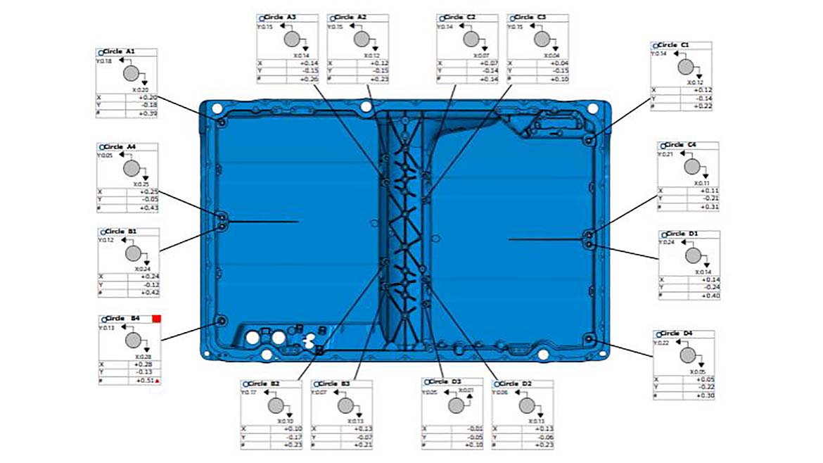

EV Battery Tray Data Hole Positions
This can quickly digitize a battery tray, allowing EV manufacturers to perform additional measurements and analyses at any point, helping to redefine new measurement criteria and to support faster process change.

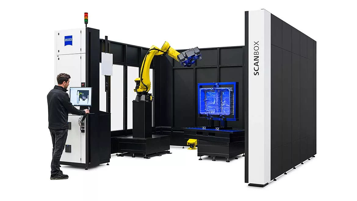

Noncontact automated blue light 3D scanning offers EV manufacturers a faster way to capture more data during an inspection by digitizing the entire surface of the battery tray. Not only does this provide a geometric digital twin that delivers deeper insight into what is happening with the part, but automating the inspection process also optimizes inspection time, increases measuring capacity, and improves the analysis and reaction time of necessary process changes.
Performing automated inspection with this method is simple: after the battery tray is loaded and secured into the automated 3D scanning inspection cell, the blue light 3D scanning sensor, mounted onto a robotic arm, moves around the battery tray, collecting millions of accurate XYZ data points per scan. Single scans are combined reliably using reference points and surface matching within advanced 3D metrology software. Common reference points on the battery tray allow both sides of the tray to be scanned and aligned for a complete digital twin of the battery tray that is useful for comprehensive data analysis and further enables the advantages of digitalization.

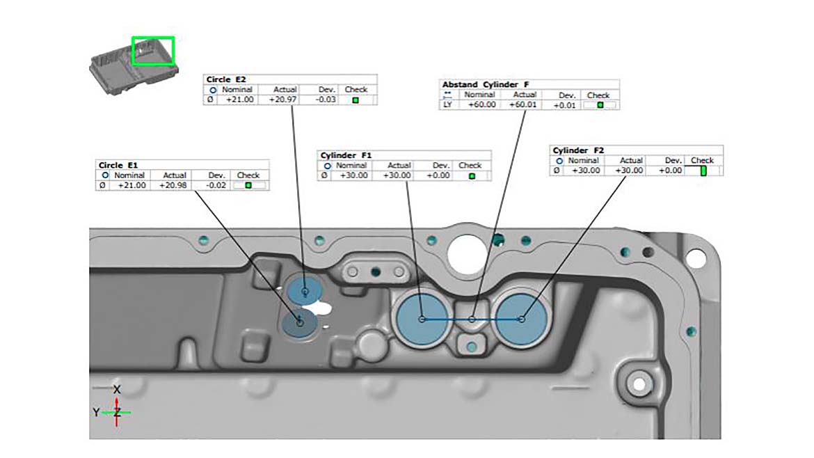

Within a few clicks, this software inspects the position of battery tray connection holes, applying geometric dimensioning and tolerancing (GD&T) checks to quickly and visually reveal deviations in shape, such as flatness, or changes in position.

Adequate securing of the battery tray helps to ensure its ability to handle load forces during driving, charging, and in the event of an accident, making validation of the size and location of the welded connection points critical to fit and finish. Inspecting the connection holes is faster and more effective by analyzing an accurate digital twin of the part inside 3D metrology software. Within a few clicks, the software inspects the position of the connection holes, applying geometric dimensioning and tolerancing (GD&T) checks to quickly and visually reveal deviations in shape, such as flatness, or changes in position.

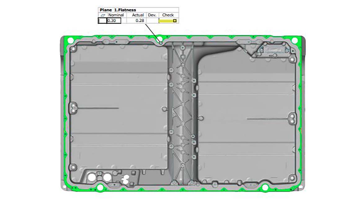

Flatness inspection of the mating and sliding surfaces is also essential for properly integrating the tray into the car body. GD&T functions within 3D metrology software can calculate the flatness or surface profile of sealing surfaces or individual battery compartments, including the height and position of the sealing bead.
