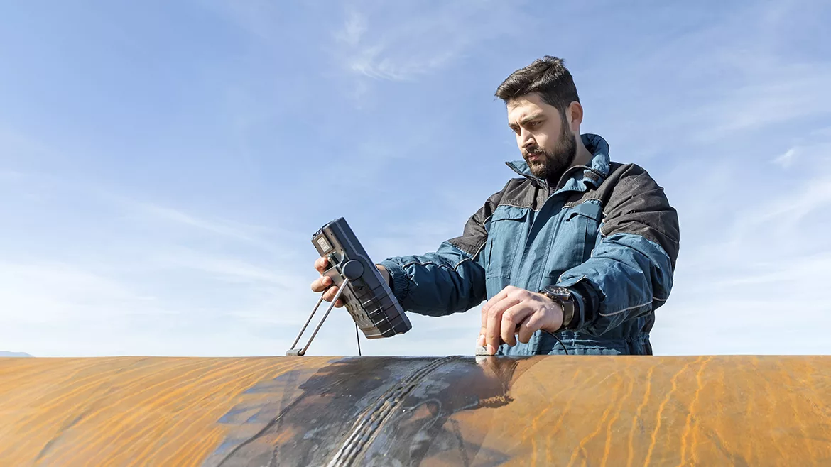

Inspector is testing welds with ultrasonic testing (UT), a non-destructive testing technique based on the propagation of ultrasonic waves in the object or material tested.
Image Source: Funtay / iStock / Getty Images Plus
