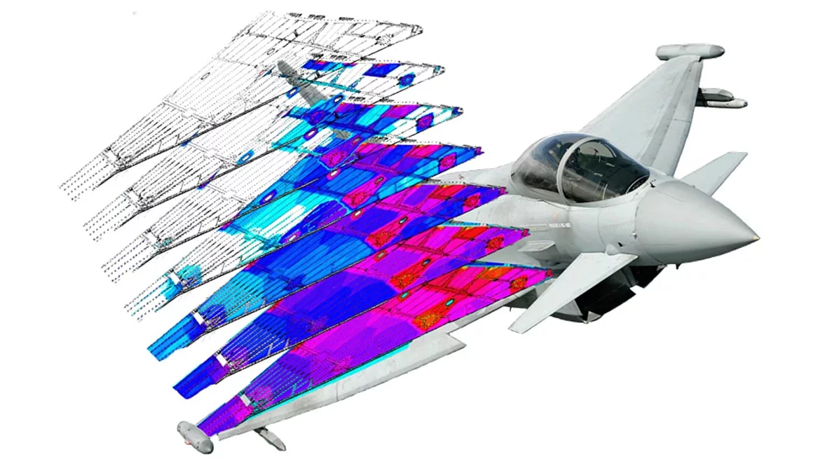

Test and Inspection C feature Figure 4: Layered depth information (great for management presentations).
Figure 4. Layered depth information (great for management presentations). Image courtesy of Testia UK Ltd
