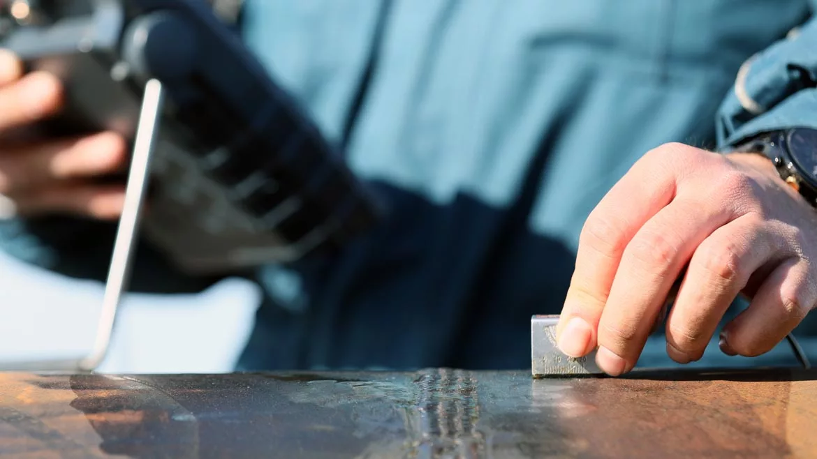

Phased array (PA), commonly referred to as ultrasound in the medical field, has been extended for industrial applications and is quickly replacing conventional angle beam ultrasonic testing (UT). While conventional ultrasonic testing utilizes single crystal probes with a fixed beam angle such as 0⁰, 45⁰, 60⁰ and 70⁰, phased array by applying time delays on multiple crystals sweeps the beam over a range of angles. This feature allows full coverage and inspection with a single phased array probe instead of multiple fixed angle probes. The time delays applied to the individual crystals are mathematically calculated to focus and sweep the beam. These are called focal laws. Using a single PA probe instead of multiple conventional probes allows simplification of manual as well as mechanical and automated UT scanners. Another advantage of phased array ultrasonic testing over conventional ultrasound is that while conventional UT displays a time based A-scan signal, phased array UT displays a sectorial image representing cross-section of the tested part. The sectorial image is much easier to understand and interpret instead of an A-scan signal that requires plotting on a component drawing. Figure 1 shows phased array probe placed on steel block with three side drilled holes and a notch. The corresponding image shows a 1:1 relationship showing the three holes making it easier for the technician to understand and interpret. Similar displays can be seen when inspecting welds and other complex geometries.

Scan Coverage: Scans should show 100% coverage of the volume being inspected. Coverage does not just mean flooding the volume with sound but also assure that sound is reflected back to the probe. This is important when planar reflectors such as lack of fusion are expected. Planar flaws act like mirrors and reflect the beam based on the angle of incidence.
Calibration Blocks: When conducting code inspections, the calibration block curvature and thickness shall be as per the applicable code. For example, when conducting ASME piping inspections, curved calibration blocks shall be used for diameters less than 20 inches with calibration reflectors as specified in the ASME V, Art 4.
Reference Level: This value refers to the gain setting. Gain setting is established on calibration reflectors as required by the specification and typically adjusted to obtain 80% full screen height (FSH). For ASME inspections, gain should be set to not only obtain 80% FSH at one angle, but 80% FSH for all of the angles across the sweep angle range and the range of inspection. Therefore, if the sweep angle range is 40⁰ to 65⁰, the calibration should assure 80% FSH for each angle, and for reflectors to cover the full sound path. This process is done by following calibration steps that adjusts gain for each angle or focal law. A time corrected gain (TCG) is applied to adjust gain over the sound path range.
