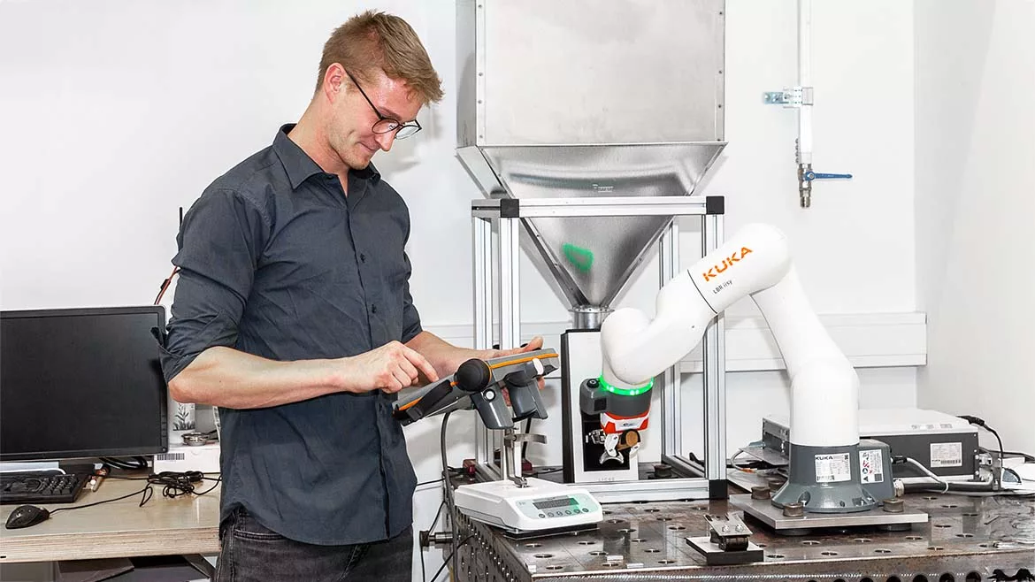

Once the R&D department acquired the LBR iisy, they quickly set it up and trained it to perform a series of steps. The cobot would initially move the siji’s portafilter to a precision scale to obtain a tare weight. It would then move it to the grinder and wait for the grinding process to be completed. From there, it moved it back to the scale and recorded the net weight of the amount of coffee ground. Lastly, it would empty the portafilter before starting the process anew.

The Gronbach R&D team was particularly impressed with how easily the process was programmed once the cobot was in their testing lab. The LBR iisy features a Teach button that streamlines programming through human-robot interaction.
“You can guide the cobot manually to teach it the desired movements and waiting times,” explains Michael Reindl, account manager at KUKA Robotics. “It’s very easy, with just the press of a button. This allows for flexible application options and it can be commissioned and operated quickly and reliably, whether by automation experts or robotics beginners.”
Over the span of two months, the cobot performed this sequence 55,000 times, validating the performance of the design of the siji coffee grinder.
“Our aim was to test the grinder’s simulated service life to gain insights into wear and accuracy,” explained Dipl.-Wirt.-Ing. Alexander Fahringer, technical development and test engineer at Gronbach. “The grinder worked so well that it indicated practically no wear and tear after simulating ten years of use, so it would last for significantly longer.”
