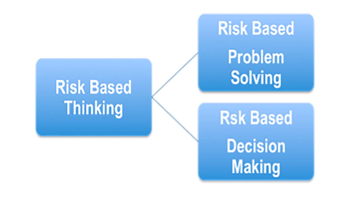

ISO 9001:2015 Risk Based Thinking
In 2015, ISO 9001 was updated with the concept of Risk-Based Thinking (RBT). This was significant because it impacted more than 1 million certified companies. Great idea. Great timing. However, RBT again challenged companies. How does a company operationalize and audit its thinking? Hard if you haven’t taken Mind Reading 101.
Risk-Based diagram
Source: Quality Plus Engineering
Let’s look at this a little deeper. To plan, conduct, and report an independent audit, the auditor and CB’s needed an audit trail of evidence including artifacts, flowcharts, supporting documentation, interviews, logical decisions, and findings. To some companies RBT was a little vague. This is hugely important since consistency is the hallmark of quality, where definitions are clear and processes are stable, capable and improving. To operationalize RBT, we suggested to our clients thinking of RBT as risk based, problem solving and risk based, decision making. Both of which can provide a certifiable audit trail.
