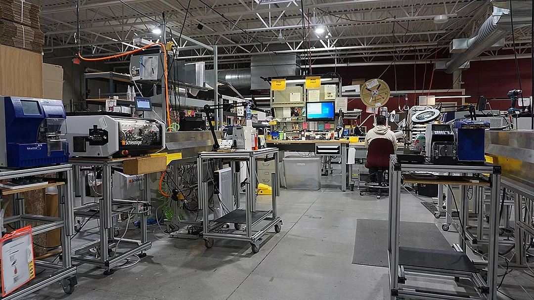

How is the factory floor automation initiative progressing at RSD?
DD: We’re making excellent progress. We expect to have four of our five primary manufacturing processes fully automated by year-end, barring any unforeseen vendor lead time challenges. And, of course, when we wear multiple hats internally as a small business, sometimes staff resources are temporarily allocated elsewhere, though we do work hard as a small business to minimize those diversions in the interest of maintaining forward solid progress.
Once completed, this automation will allow one of our most significant manufacturing cells to be predominantly automated across all of its primary processes and interconnected. Our first automation priority was the automation of our potting process, but we’re on track to enhance our other production capabilities further.
