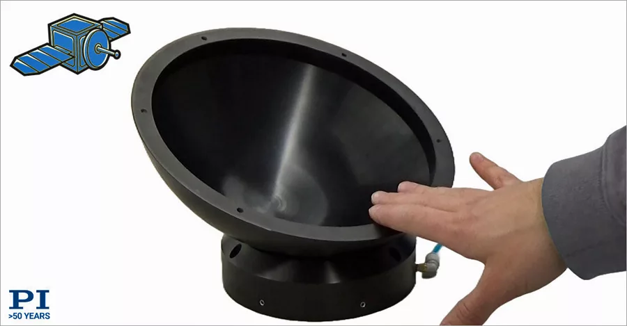

Spherical air bearing systems are commonly used to test the attitude control systems of small satellites. The frictionless nature of the spherical air bearing makes it easy to simulate a zero-gravity environment, allowing the satellite’s pitch, roll, and yaw control systems to function as they would in space without cumbersome and expensive test simulations, such as traditional drop testing.
PI’s A-651 and A-657 series of spherical air bearings offer frictionless motion in three rotary degrees of freedom with unrestrained rotation about the vertical Z-axis and ±45-degree tilt motion about the horizontal X and Y axes. They are available with diameters from 50 to 300 millimeters and can carry payloads 20 to 1,400 pounds with compressed air at 80 psi.
These bearings can handle nearly any small satellite, from picosatellites to half-ton mini-satellites. The moving element of the PIglide HB spherical air bearing is lightweight to reduce moving mass and moment of inertia, ensuring the test system closely simulates actual satellite behavior.
