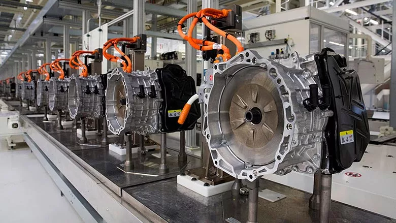

assembling transmissions
VW’s assembly plant in Kassel, Germany, produces 3 million transmissions and electric drives annually. Photo courtesy Volkswagen
