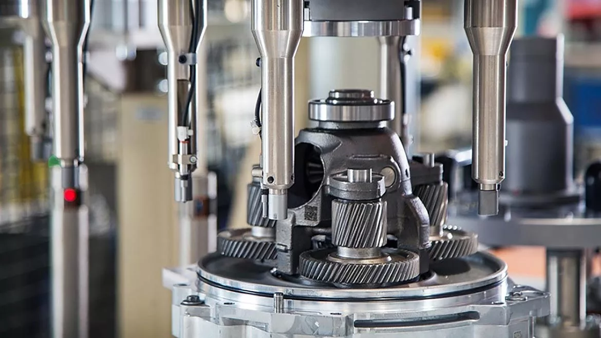

Earlier, we mentioned the importance of reduced noise on all drivetrain components. Until recently, a noise analysis - better defined as NVH (Noise Vibration Harshness) study - was performed on the assembled gearbox as a functional end-of-line test. However, now that ensuring a silent gearbox has become of paramount importance, the identification of potential noise-producing components must be moved upstream in the process.
The big question that arises is the relationship between the NVH testing of individual gears and the expected NVH behavior on the final transmission assembly. In the past regarding ICEs, the gear boxes were much more complex, full of gears with lower technical requirements, and connected to a noisy combustion engine; the noise was not a problem. With the growing implementation of BEV, it is now believed that the simpler lay-out of the transmission has made it possible to reveal the impact of the gears on the complete assembly. In addition, the requirements for NVH testing of the gearbox assembly became more stringent in the BEV, forcing transmission manufacturers to adopt 100% NVH testing on individual gears.

NVH evaluation based on a single component allows for the identification of defects such as micro-geometry errors on a gear, helping to avoid issues that are much harder to solve at the assembly stage. This represents an invaluable benefit in terms of time and money saved for manufacturers. In addition, the NVH test makes it possible to identify defects on the gear flanks that are not normally detectable with the traditional production quality tests (double flank roll checkers, DOB/MdK measurements). These tests are very effective at the early or intermediate stages of the manufacturing process (after hobbing or shaving operations, before and after heat treatment), while their contribution is no longer a “plus” when the gears are already ground, polished or honed, which is a normal requirement for gears used in e-mobility.
For instance, a gear that is machined within the manufacturing tolerances and passes traditional measurement checks may still produce noise at certain frequencies in the gearbox. This event is known as the ripple phenomenon, which is responsible for creating frequencies with amplitudes above the expected threshold (ghost orders). Ghost orders arise from micro-surface problems in the profile and lead directions of the gear flanks.
The main source of noise originates from accelerations that repeat consistently at every part revolution; a part that is geometrically perfect could be noisier than one with a small amount of defects as the presence of defects on the teeth allows the energy to dissipate. Gear manufacturers are struggling to understand how to introduce a controlled amount of variations in the gear teeth to achieve the goal of a silent gear. Which is tricky because from an engineering standpoint, the gear must be designed and manufactured with the lowest number of possible imperfections to ensure the proper mechanical reliability. On the other hand, the challenge is to introduce form deviations that reduce the amplitude of certain orders during meshing.
The NVH test on a single gear analyzes accelerations through a torsional accelerometer sensor. To accomplish its metrological task, the system requires a considerable amount of energy. For this reason, the measurement is performed at high speed (400-3,000 rpm), while the traditional transmission error test is performed at a lower speed (30 rpm).
The signal from the sensor is elaborated to obtain a fast Fournier transform (FFT) that shows the amplitude of the vibration frequencies. This process breaks down the signal into its frequency components. As a result, the system provides the amplitude values of each frequency component, which, when added together reconstruct the complete frequency spectrum of the gear under inspection.
Fourier analysis can be used to understand the possible root causes contributing to non-conformity of a noisy gear. The type of peaks detected over the FFT spectrum of the gear may have different origins, but all of them are related to the manufacturing process. For example, it might be due to an offset (misalignment) that occurred on the grinding wheel, generating eccentricity. In other cases, it may indicate local pitch errors or profile errors due to a division error on a machine tool, or a non-conformity could occur due to an unbalanced grinder or from vibration of the grinding tool.
