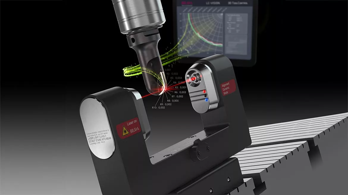

LC50 DIGILOG Datenstrom
The LC50-DIGILOG tool measurement laser system from Blum-Novotest, uses proprietary DIGILOG technology to automatically measure live tool length, diameter, runout, and more.

LC50 DIGILOG Kugelfraser
The LC50-DIGILOG makes use of proprietary Blum-Novotest DIGILOG technology, which combines digital and analog measurement technologies. Image Source: Blum-Novotest

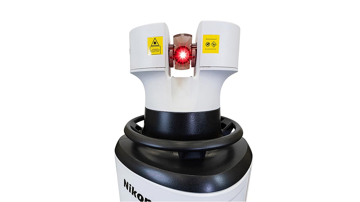

NIKON APDIS 19
Nikon APDIS MV430E Laser Radar ready for automation Image Source: Nikon

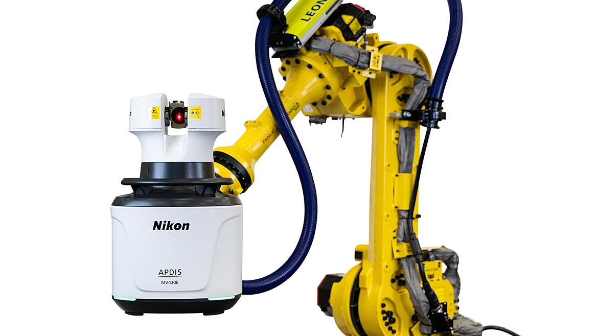

NIKON APDIS 19

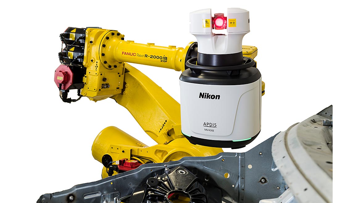

Nikon APDIS MV430E
APDIS MV430E Laser Radar is used widely across automotive manufacturing Image Source: Nikon
