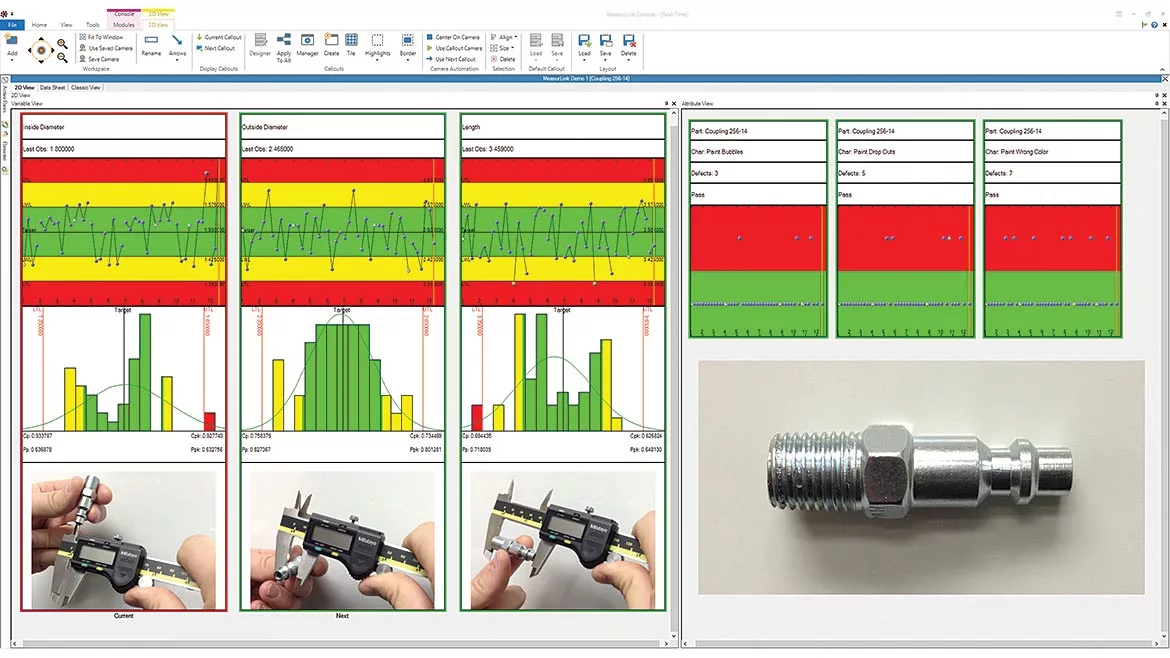

A real-time measurement dashboard
A real-time measurement dashboard highlights each feature’s performance and Cpk values, enabling operators and managers to quickly spot trends, prevent defects, and optimize processes. Image Source: Mitutoyo

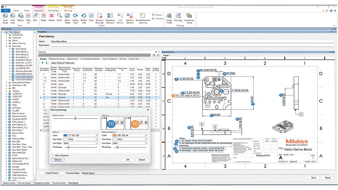

Automated OCR ballooning screen
Automated OCR ballooning links each dimension and tolerance from the print directly to real-time inspection data, ensuring faster, more accurate traceability for every measured feature. Image Source: Mitutoyo
