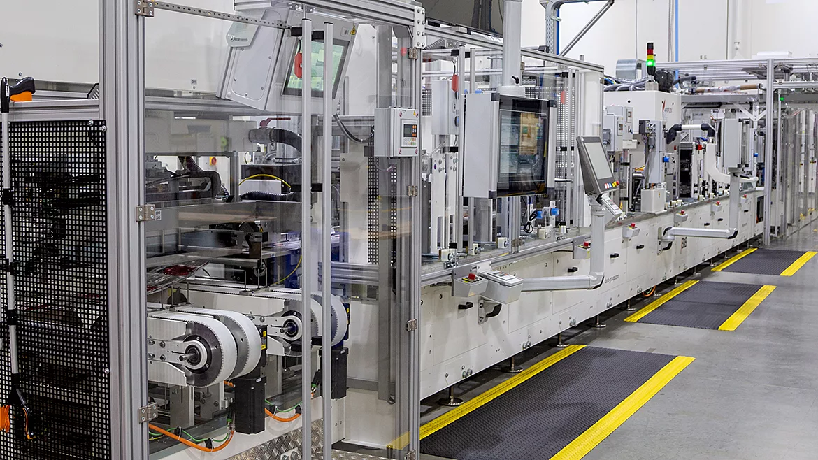

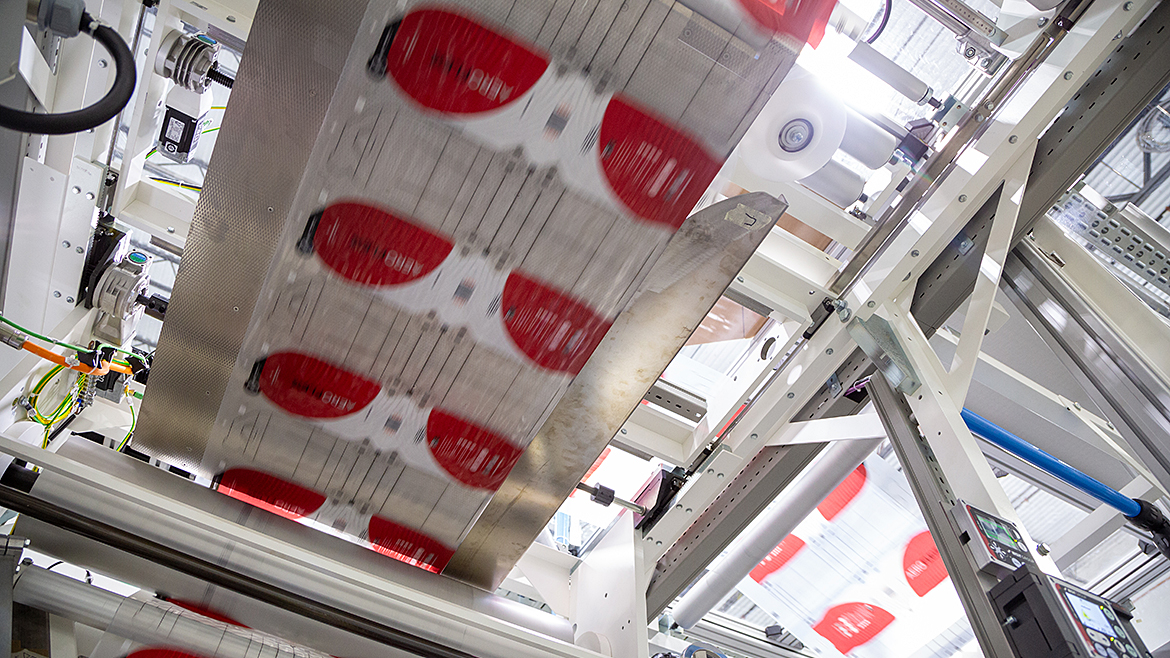

AeroFlexx has built its reputation on disrupting traditional rigid packaging with its sustainable package that combines the best qualities of flexible and rigid bottles to create an entirely new format for liquid packaging. Central to its success is the converter line, a highly engineered system that shapes and seals each AeroFlexx Pak with precision.
As their process around the converter developed, they identified one crucial pain point. Operators needed to make on-the-fly adjustments to process parameters, but typical HMIs were too small, cluttered, and limited for high-speed decision-making. AeroFlexx needed a better way to make real-time data visible—and in a big way.

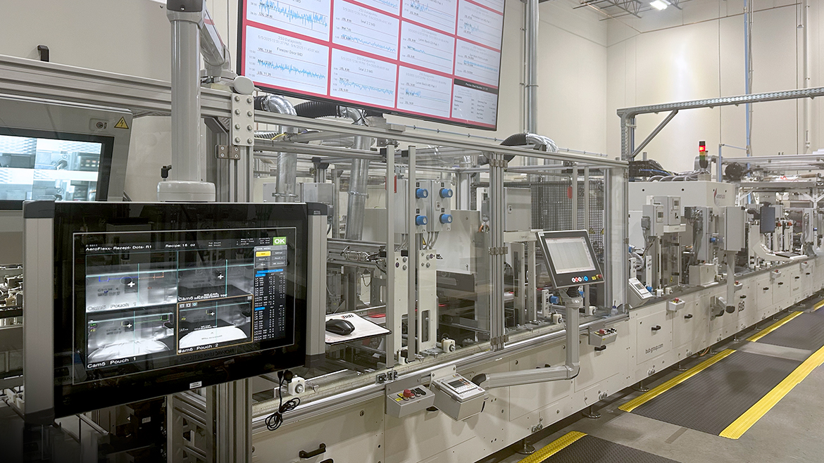

Once FS.IoT had the data flowing into FS.Net, the data is displayed in FS.Display, a customizable dashboard application designed specifically for factory floor use. Built to run on low-cost streaming devices connected to standard televisions, FS.Display turned any device with a web browser in the facility into a potential dynamic operations board. With an easy to use browser-based configuration UI, AeroFlexx’s staff was able to easily implement their data philosophy in many customizable dashboards available to display at will.
Each dashboard was tailored to its location. Near the converter line, AeroFlexx’s operators viewed quality metrics, live status, defect rates, and material usage trends.
On-screen metrics included:
  • CPK (Process Capability Index) for quality trends
  • Total production counts for throughput monitoring
  • In-spec vs. out-of-spec counts for real-time quality visibility
  • Live charts of key measurements visually indicating their quality
In the office near the engineers pareto charts of downtimes along with their causes were added.
“The dashboards were a game-changer,” said Mike Brentar, AeroFlexx’s operations manager. “Everyone sees the same truth in real time. No more walking over to an HMI or pulling manual reports, it’s just there.”
