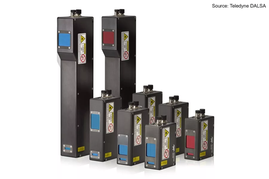

Teledyne DALSA introduced the Z-Trak™ Express 1K5 3D laser profiler series. Purpose-built for cost-effective, in-line 3D measurement and inspection, the Z-Trak Express 1K5 is the latest innovation in the Z-Trak family. It delivers high-speed 3D inspection with real-time processing, achieving a maximum profile rate of 5,000 profiles per second across its full measurement range. This makes it ideal for a wide range of industries, including secondary battery production, automotive, lumber inspection, factory automation, and logistics.
Featuring a 1,700mm horizontal field-of-view, the Z-Trak Express 1K5 enables precise measurement and inspection of wide-body objects such as wooden planks, road surfaces, pallets, and automotive body parts, using a single sensor. It also supports the integration of multiple sensors in a variety of topologies, enabling advanced measurement and inspection tasks such as measuring the thickness of moving parts, performing continuous 360° inspections, and extending the horizontal field-of-view, all without compromising Z-resolution. To simplify deployment and reduce costs, the Z-Trak Express 1K5 synchronizes multiple sensors using a data cable and supports content-based triggering for enhanced flexibility.
All Z-Trak profilers are deployment-ready, delivering micrometer level measurements without the need for in-field calibration. To accommodate objects of varying sizes, shapes, colors, finishes, and material compositions, Z-Trak Express 1K5 includes real-time, user programmable profile enhancement functions, two-point HDR, and models with eye-safe red or blue lasers. Like all Z-Trak laser profilers, Z-Trak Express 1K5 performs on-board processing without compromising the profile rate.
